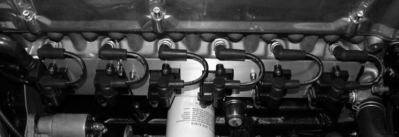

I'm using Wolf3D to drive cousin coils from a truck (part#12558693). I prefer these due to the slightly more compact packaging and the low voltage ports originating from the 'bottom' of the coil. Allegedly, they are electrically identical. I'll be shipping one to "Z-Ya" shortly for confirmation, per this great thread by Pete... http://forums.hybridz.org/showthread.php?t=120533
No modifications to the coils are necessary with the bracket pictured below...
Its a snug fit to be sure, but the outcome is fairly clean...
Mount's are circled in red...
The heater hose is mounted to the top of the block with two clamps. Re-routing the hose frees up a secure place for the coil bracket. Long machine screws with .460" spacers behind the bracket stand it off nicely.
Custom length Magnecor wires top it off.
For more information about the above installation...http://forums.hybridz.org/showthread.php?t=119783
