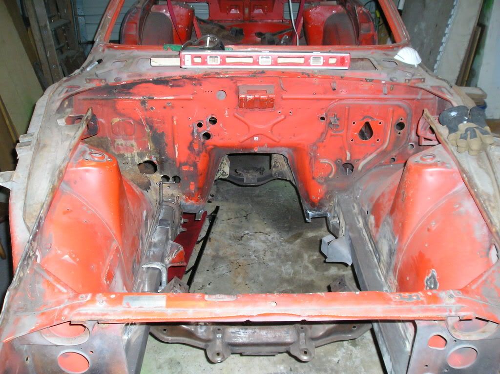

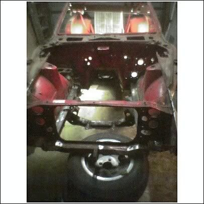

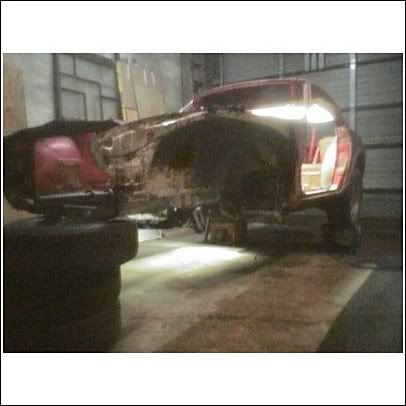

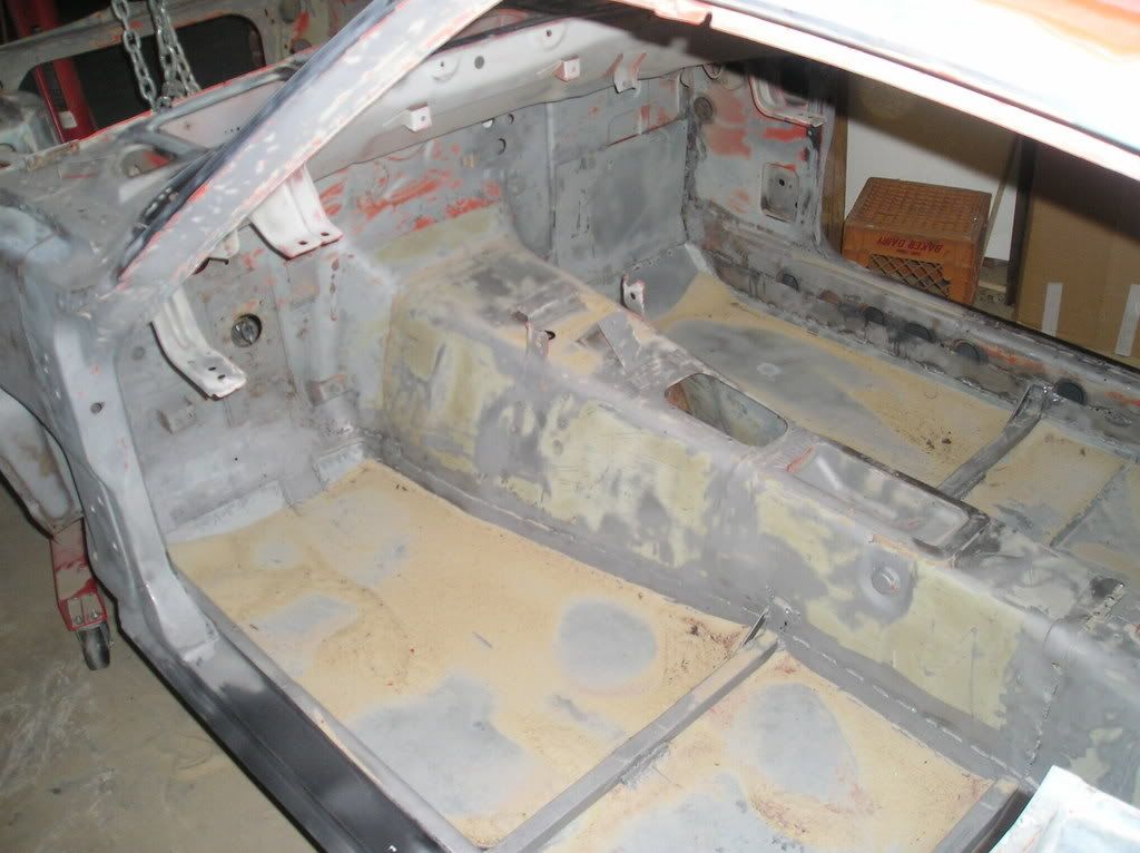

This project is a 1973 240z, that looked okay on the surface. Once the surface was broken, the true condition became apparent. A ripple effect began. Finding one ring of rust, lead to another.

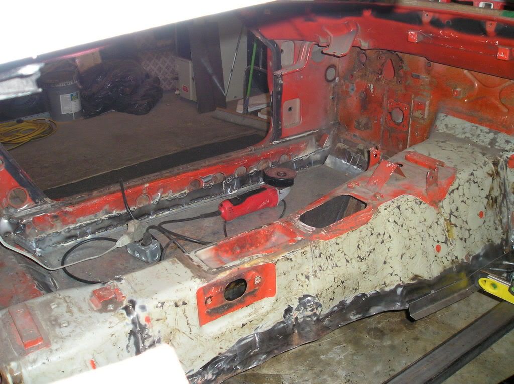

I started by removing everything but rear suspension from the shell. While doing this, I found the majority of rot that the car was suffering. It seemed pointless to sandblast the shell. I just started to cut out the cancer, strategically, replacing and reinforcing the metal work as I proceeded.

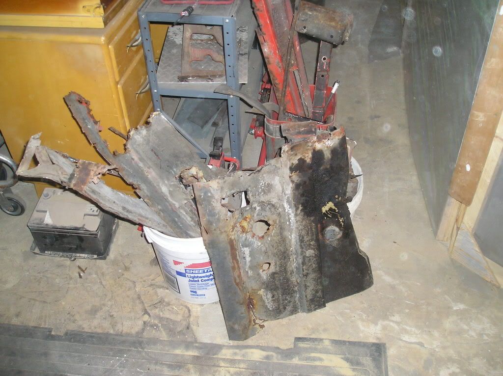

This is just the beginning. I am collecting and saving every piece of rusty metal and every ounce of rusty dirt that I sweep off the floor as I go. I will gather it all up and weigh it in, once I am satisfied that the removal of it all is complete. More than anything, I just want to be able to say that I removed "x" number of pounds of rust, from this beast.

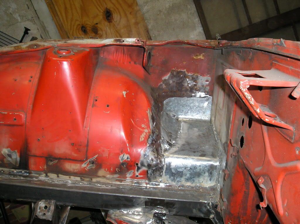

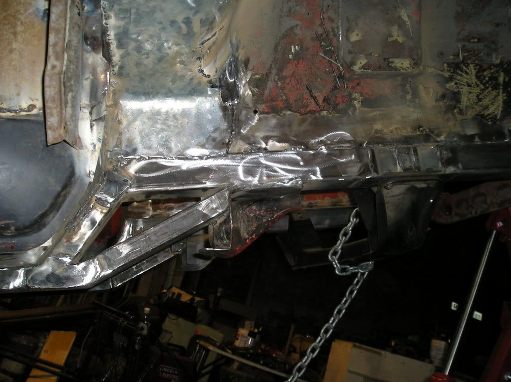

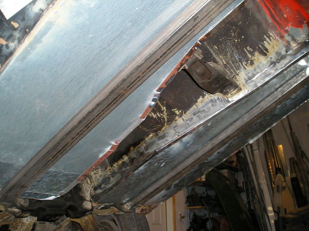

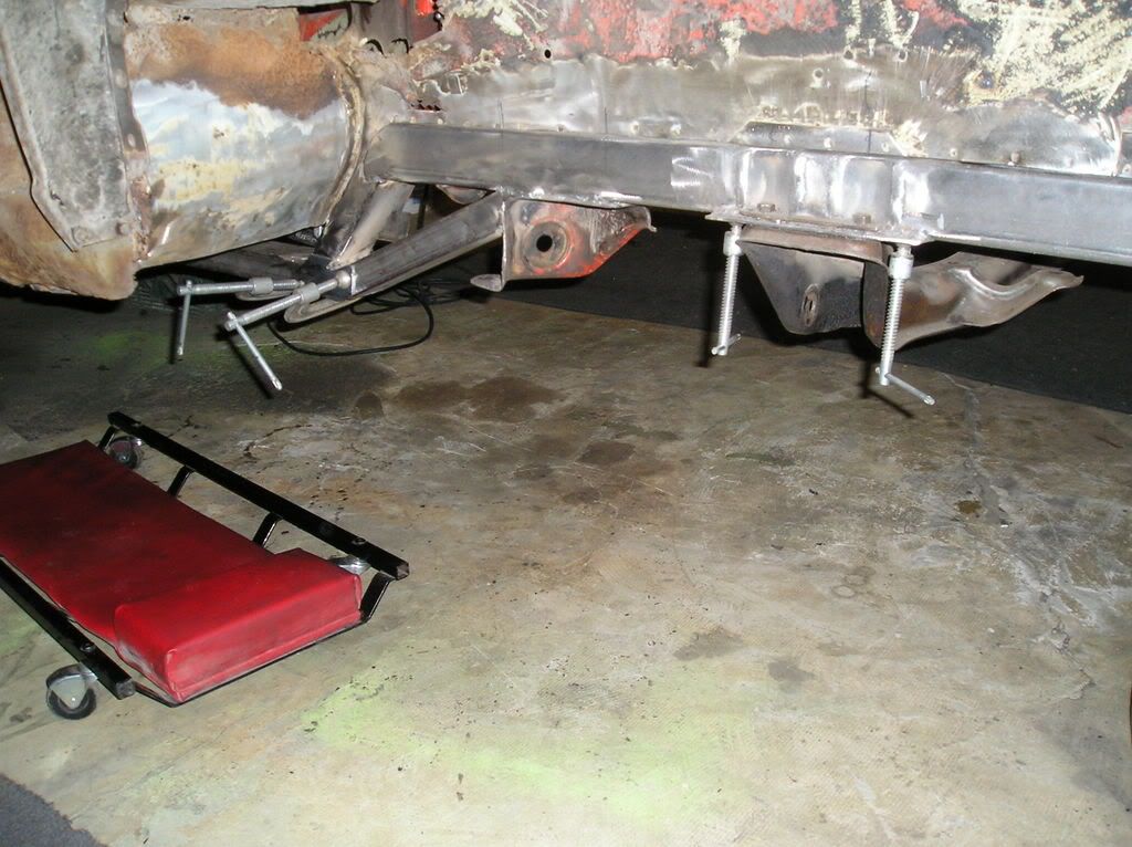

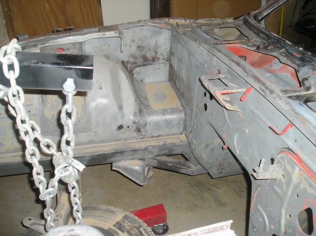

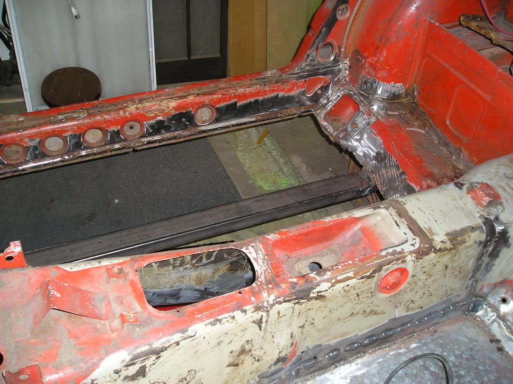

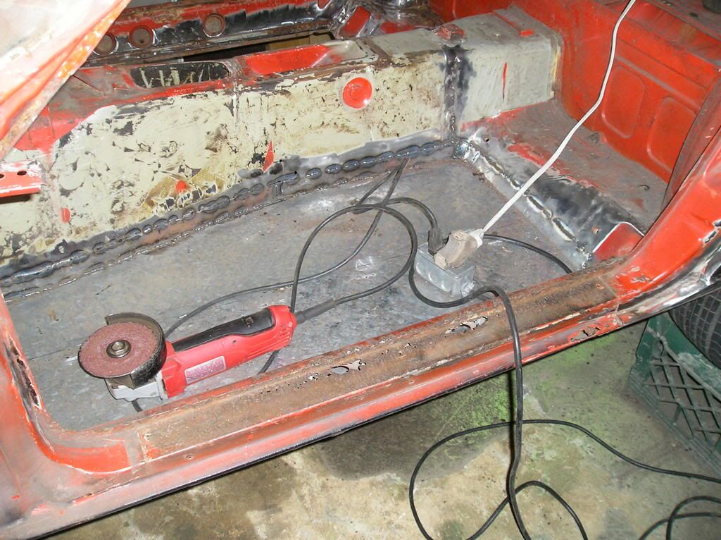

So, I so far have installed new 2 1/2" front rails with 2 1/2" x 1 1/2" rear rails that connect to the cross member that the rear sway bar mounts to.

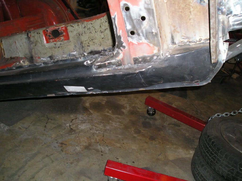

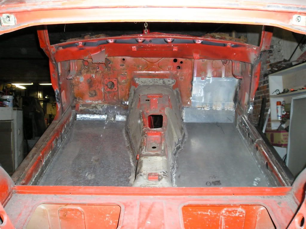

I have replaced the floor pans with "skid plate" 16 gauge galvanized sheet, against the advice of some. I have done the same in the battery box. I have installed new rocker panels and dog legs. I have been able to MIG fill some small holes in the rear fenders. I have piece-mealed the tail/hatch deck successfully, I think.

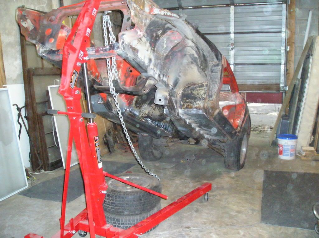

I am doing this without a rotisserie. Since I left the rear in, I can lift up the front high enough to get to it all.
Still more to go.
