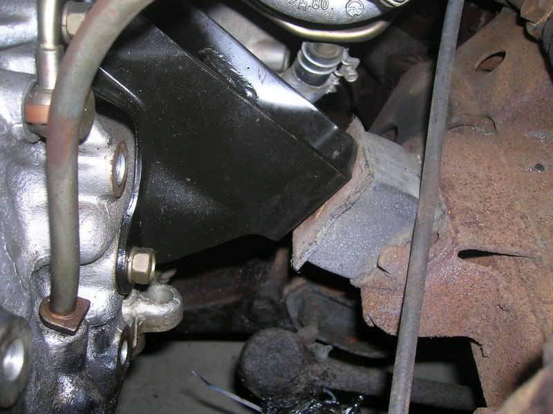

Roostmonkey Posted October 3, 2007 Author Share Posted October 3, 2007 Heres how close it was to just dropping into perfect place. I'll replace the old isolator with a beefier set with the same dimensions.If only everything else went this easy. Quote Link to comment Share on other sites More sharing options...
Roostmonkey Posted October 6, 2007 Author Share Posted October 6, 2007 I got the mounts done and clocked the turbo.Everything was welded inside and out and Por 15'ed When the paints dry, back in it goes. Quote Link to comment Share on other sites More sharing options...
Roostmonkey Posted October 7, 2007 Author Share Posted October 7, 2007 Well, when something seems too easy, its usually wrong. The motor set back into place perfectly, everthing lined up dead nuts. Turns out, the motor also needs to shift !/2" towards the passengers side to give some clearance for the turbo and steering column.Back to the bandsaw ang welder. Quote Link to comment Share on other sites More sharing options...
