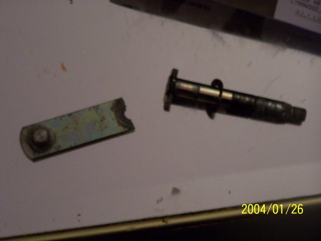

justinr54321 Posted November 16, 2007 Share Posted November 16, 2007 Not sure where this post belongs. My wipers stopped working today on the way home, the linkage broke or came undone. Don't know which yet, because someone tack welded the wiper motor frame to the chassis instead of just buying a new set of bolts. I was in the rain for about 2 hours getting off rusted bolts and screws just to find this out. Oh well, off to the hardware store to buy a cutter to get it out. Will keep you guys updated as this little project goes underway. Will post pics later as soon as it stops raining and I can get them. Any tips would be appreciated. OH, and does anyone had a wiper motor that they don't need just in case? Quote Link to comment Share on other sites More sharing options...

justinr54321 Posted November 18, 2007 Author Share Posted November 18, 2007 Anyone have any pics of the wiper motor linkage? I don't think it was rebuilt right to begin with, for the passenger wiper linkage was broken at the wiper mount. Thank you. Quote Link to comment Share on other sites More sharing options...
justinr54321 Posted November 21, 2007 Author Share Posted November 21, 2007 Well, I have pretty much everything figured out now. JB Welded the broken part of the wiper linkage, greased and cleaned up. Waiting on the new motor and the intermittent assembly to come in now. Still trying to figure out how to wire up the motor when it comes in. And as soon as I figure out how to post pics, I will. Quote Link to comment Share on other sites More sharing options...

justinr54321 Posted November 25, 2007 Author Share Posted November 25, 2007 Well, I now have the more motor mounted up, however, after I installed everything, the passenger side windshield wiper mount link sheered again. So, I'm off to a junk yard to find me a new one, if I am unable to find one online. Anyone have one? Quote Link to comment Share on other sites More sharing options...
justinr54321 Posted November 28, 2007 Author Share Posted November 28, 2007 Well, I was not able to find a replacement for the passenger side just by itself, however, I did find an online junkyard that is out of Cali, and have on the way, a replacement set of wiper linkage, only $60 after s&h. If you're wondering what the site is, here is all the info from one of the emails I received from them: To complete your order please call 916-631-8795 All parts guarranteed 6 months Check out our web site (www.sunrisenissan.net) The parts you requested are available. This is not an auto response... we actually have this part in stock. All prices quoted are subject to sales tax and shipping charges if applicable. JASON SUNRISE NISSAN & KIA AUTO DISMANTLING 3450 SUNRISE BLVD RANCHO CORDOVA, CA 95742 PHONE (916) 631-8795 FAX (916) 631-8849 e-mail: sunrisenissan@aol.com STORE HOURS - M-F 8am-5pm SAT 9am-4pm STANDARD PACIFIC They usually get back to you within 24 hours after requesting a part. I hope this helps out others. Justin Quote Link to comment Share on other sites More sharing options...
justinr54321 Posted December 1, 2007 Author Share Posted December 1, 2007 Received the wiper linkage Thursday night, took it apart and regreased it, a little corosion control, (what do you expect from a junk yard), and installed it Friday night after work, and its working like a charm. I should of took pictures as I was going along, but was in a hurry. Now, out to install the intermittent wiper controls and to see which wire is shorting out, for my steering clumn gets warm when I have my headlights turned on. Quote Link to comment Share on other sites More sharing options...
