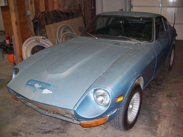

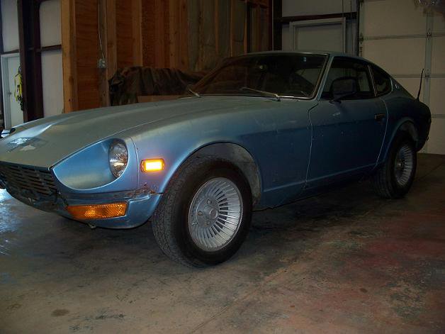

Hello, here is my little 260z. Its an early one.

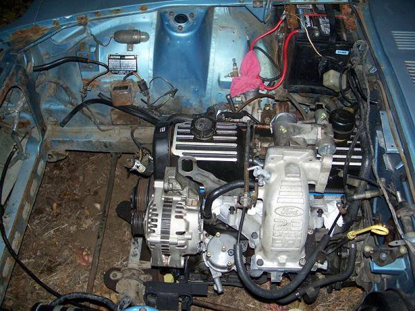

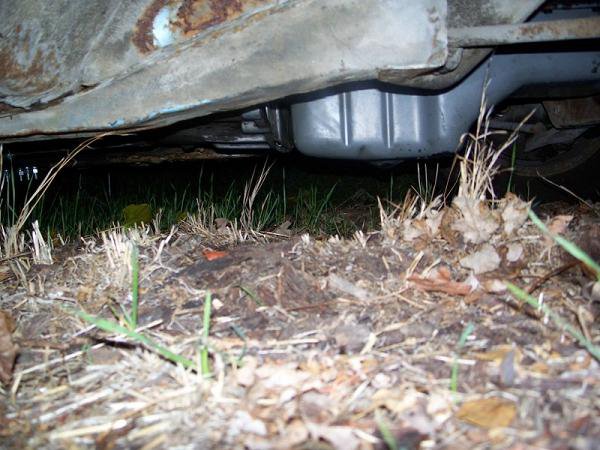

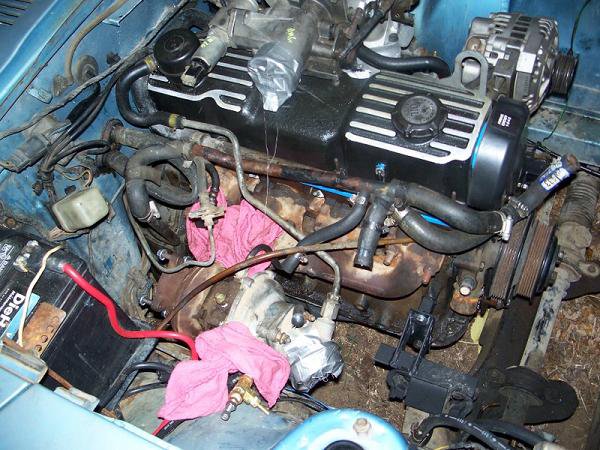

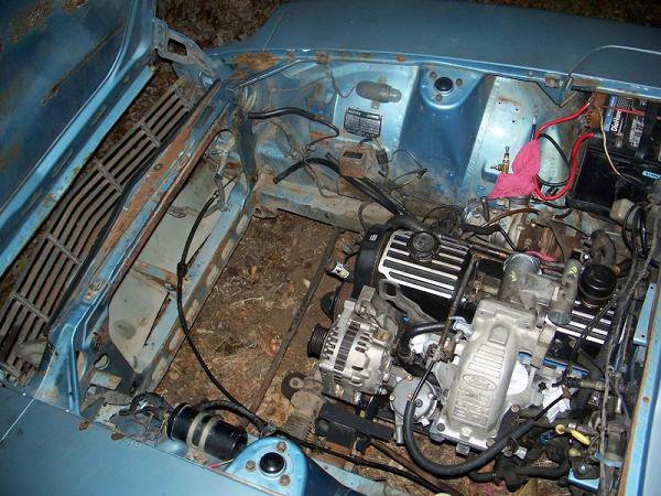

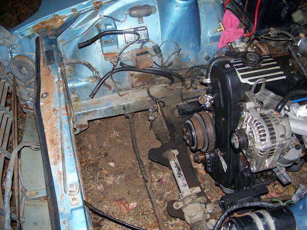

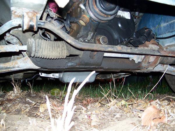

Here is the engine and transmission in their final spot. I still need to clean up the mounts a bit to make them look better, but thats where everything landed. I have small concerns about the oil pan being exposed, Im probably going to have to make a wider/shallower pan.
More pictures. Thats the smallest turbo Ford used on these engines. Its an IHI and its only safely capable of about 18 PSI. I will be using many different turbos during the life of this car. Im starting out with the small one, and will work my way up to bigger and better ones I have in storage waiting for their chance to shine. I have done more since these were taken. I will post more this weekend hopefully.

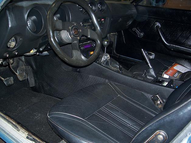

Also take a look at my dash. Its just the dash cap, I removed everything from underneath it and lost about 40 pounds. It looks great and its super light! I need to finish making brackets for the gauges, they are being made from alluminum.
