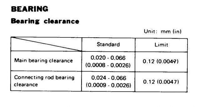

Guest nickb15ser Posted February 26, 2008 Share Posted February 26, 2008 what are the torque specs for the main bearings on the l28. chiltons says 33-4o ft. lbs. this doesnt seem right to me. if anyone can help with the specs and tolerances that would be sweet. Quote Link to comment Share on other sites More sharing options...
m4xwellmurd3r Posted February 26, 2008 Share Posted February 26, 2008 ran a quick search on l28et mainbearing and found this post http://forums.hybridz.org/showthread.php?t=90944&highlight=l28et+main+bearing it looks like chiltons is correct. Quote Link to comment Share on other sites More sharing options...
Guest nickb15ser Posted February 26, 2008 Share Posted February 26, 2008 guess i'll shoot for 38 then????????? would be nice to know what the clearences with plasti gauge are supposed to be. Quote Link to comment Share on other sites More sharing options...
Lukaniuk Posted February 26, 2008 Share Posted February 26, 2008 I think this might be what you're looking for. Cut and paste from the service manual. Quote Link to comment Share on other sites More sharing options...
