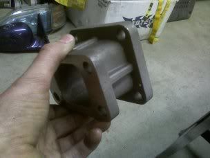

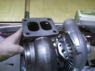

My brother wants to sell me this turbo and T3 adapter for $250. The turbo is a T3/T04B with a 1.15 exaust trim and .60 on the compressor. I dont have my engine in my car and the search button didnt yield much result, but could someone with a 280ZxT measure to see if this 2.5" adapter would fit or would it put the turbo too far towards the steering.
Edit: Oops my bad, this might be a T4. Duh, maybe if it needs an adapter to fit a T3 flange. LOL
Having tried lots of turbos on my own '83 ZXTurbo, I can tell you that there is no much space to run really large turbos due to the conflict with the steering shaft coming out of the steering wheel into the rack and pinion. This was a source of frustration for me and then I had James Thagard from SpeedShopThagard make a custom T3T4 which fits but barely!
The only way to know is to mock up the engine in the car and bolt in the turbo.
