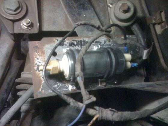

Installed a new fuel pump from Summit Racing.

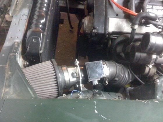

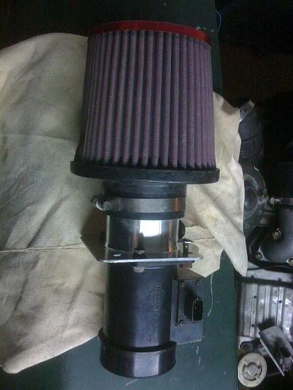

I got my MAF finally and bought an adapter from Auto Zone so it slips right onto my air filter.
Heres the whole set up installed...

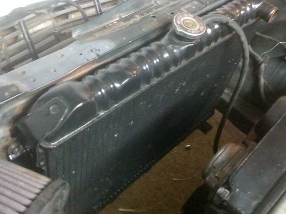

Radiator bolted up finally, fits snug.

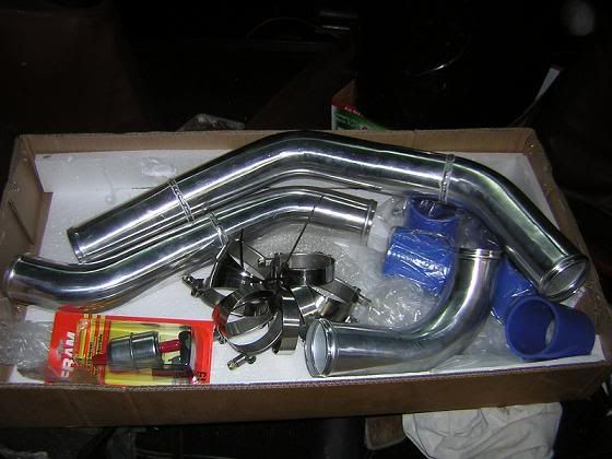

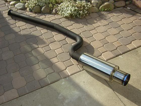

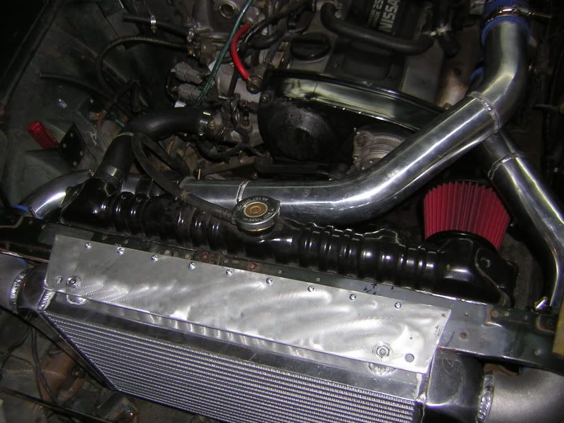

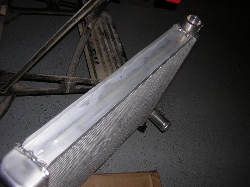

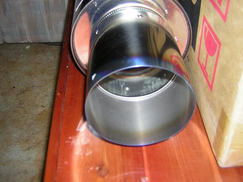

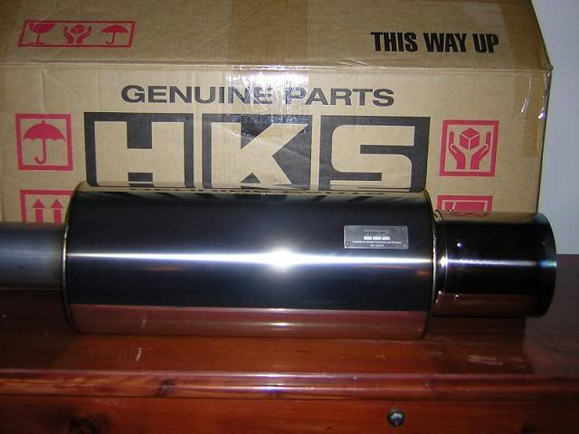

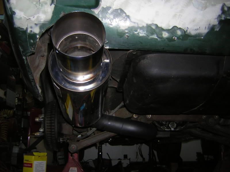

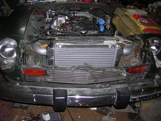

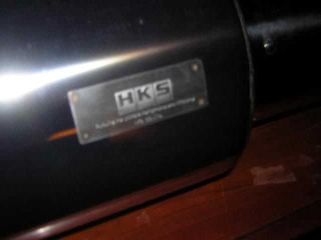

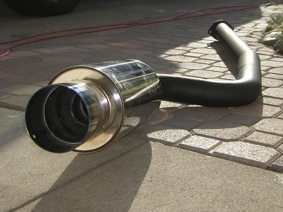

Got some parts. Downpipe, exhaust piping & intercooler kit from McKinney. Put on my muffler and began to mount it. Had to go to work so I dont got everything in. Heres some pictures so far.
Not too shabby.
Itll look better when its in...
Bad picture but thats what it looks like...

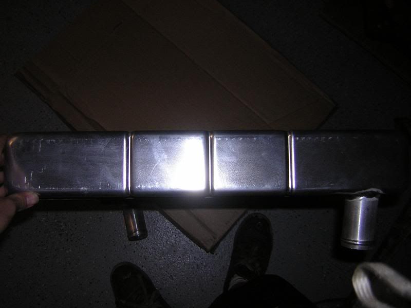

FMIC piping

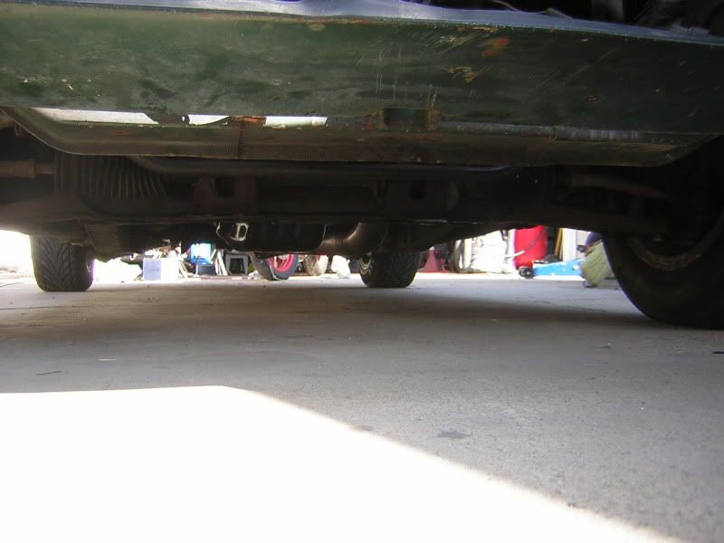

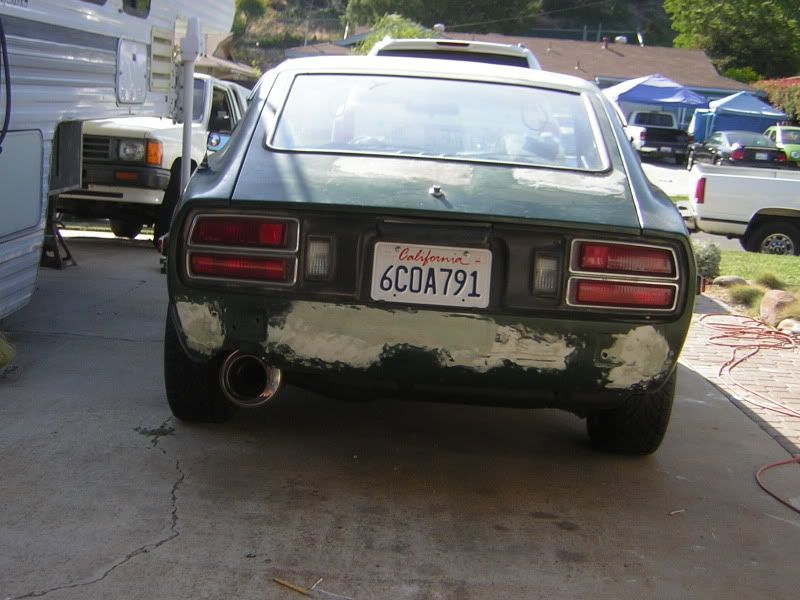

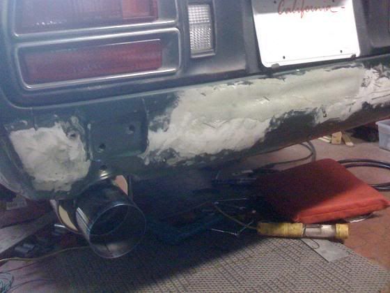

Exhaust System completely installed.

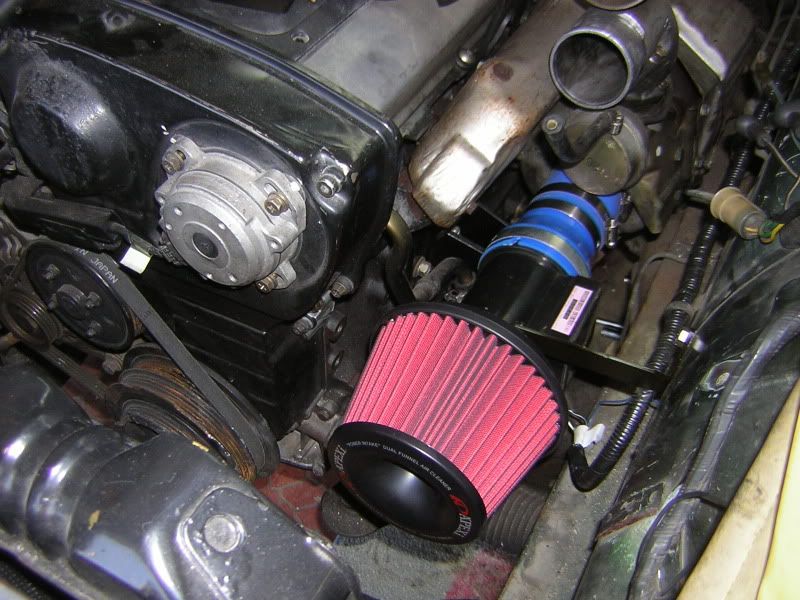

Bought an APEXi Power Intake
Installed

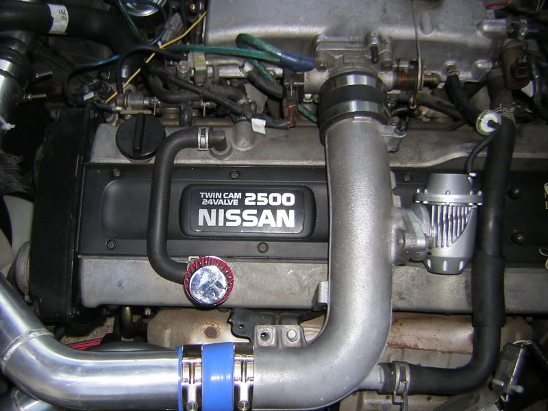

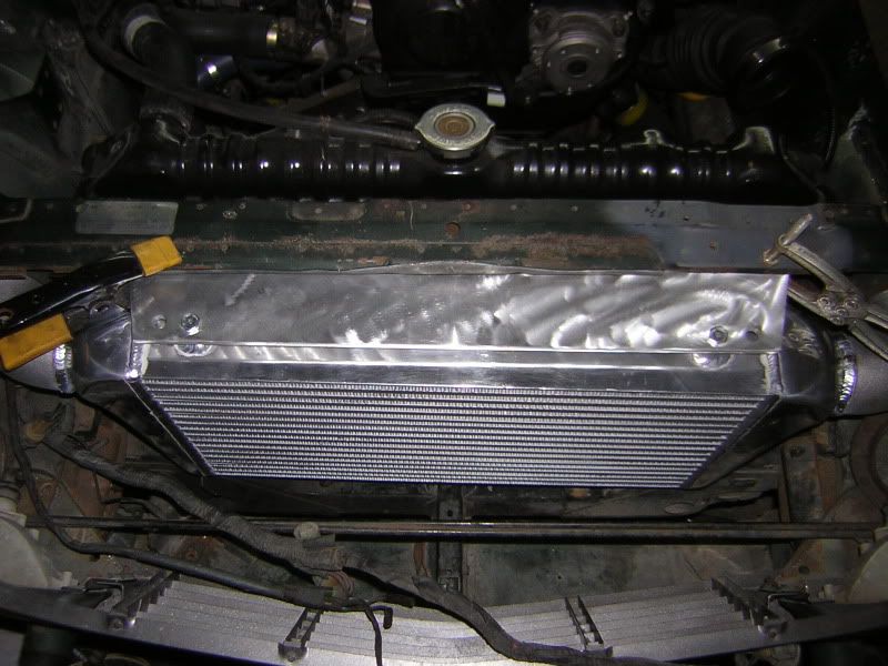

FMIC Completely installed

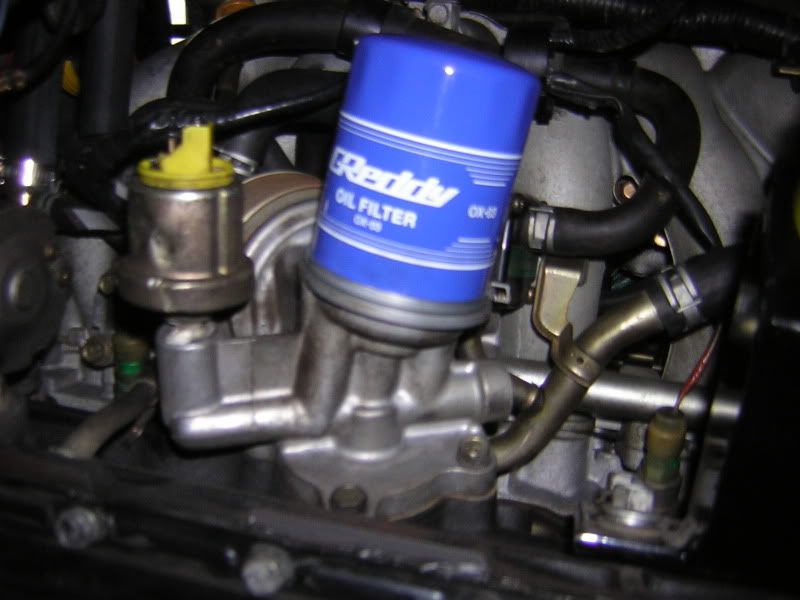

Bought a Greddy oil filter because I didnt like the fitment of the K&N filter, it seemed to cross thread and didnt fit right in my opinion.

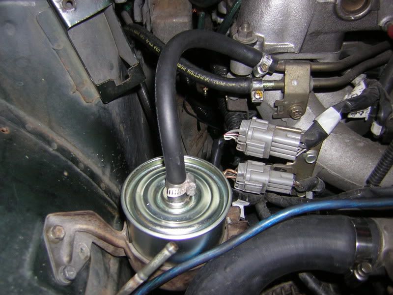

Hooked up a fuel filter.

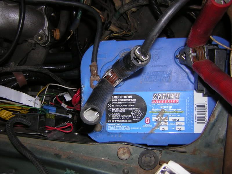

Optima battery

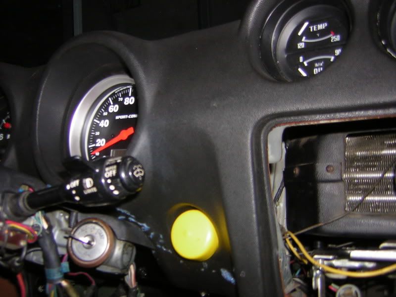

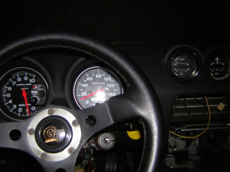

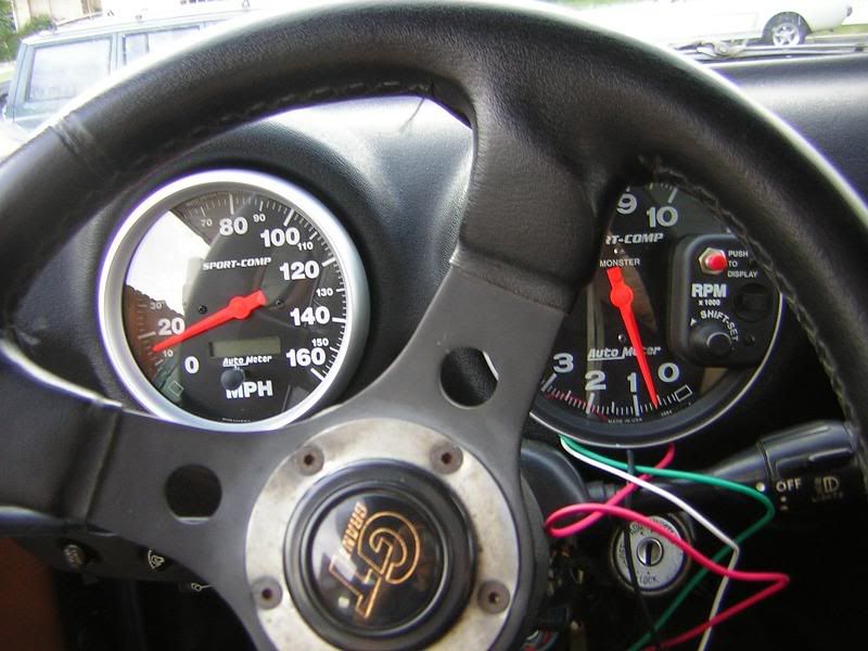

On a side note, I ordered an Auto Meter Sport Comp in-dash 160mph Speedometer to match my tach, should get here soon. I also put in an order for an HKS SSQV Blow Off Valve, but they are currently on back order from HKS so I have to wait a few weeks which kinda sucks...

Finally got my HKS SSQV. Looks great, works great and sounds great:mrgreen: HKS is pretty damn pricey but they sure put out some quality products. Ill put up a vid later of. I also put in my gauges that Ive had for a while and changed out the cigarette lighter in favor of a shift light.

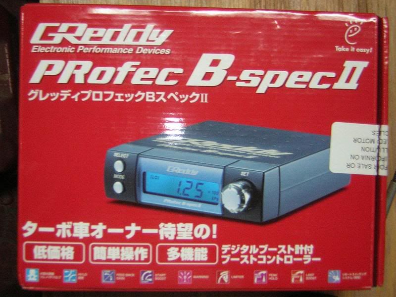

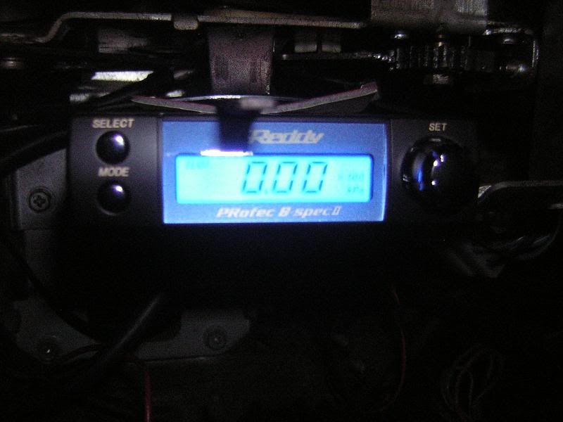

I got a Greddy Profec B Spec 2 for the Z and have been tuning it, the car runs a lot better with it. I am going to get the boost up to 10psi, I got the peak boost pressure up to 8.6psi so far.
The Box
Heres the head unit installed on the car
Ill post more pictures soon and a video soon.
More on the Boost controller...

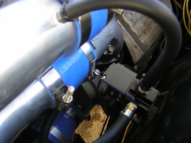

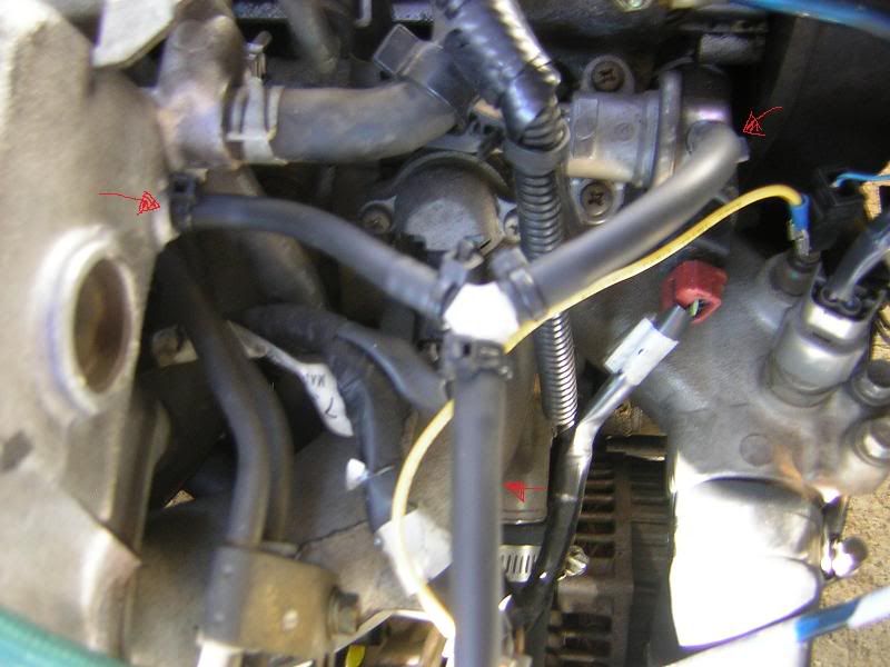

Here is the solenoid that connects to the wastegate.
This is the the vacuum side.
Here is a short vid of it operating.
By the way for you guys that have just gotten one of these, MAKE SURE you change it into PSI mode if that is what you want to read or else it will screw you up. If you have one of these controllers or are thinking of getting one don't hesitate to PM me if you have any questions in regards to the RB25 installation and programming. I would highly recommend one of these, they are easy to use, install, the directions are in English and easy to understand, its not overly expensive and has performed beautifully so far.

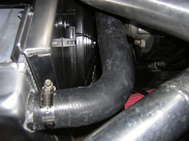

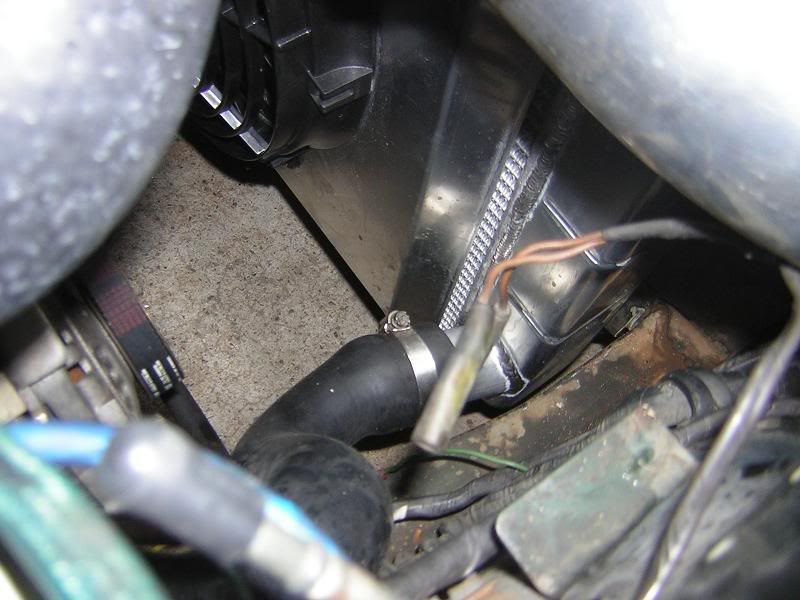

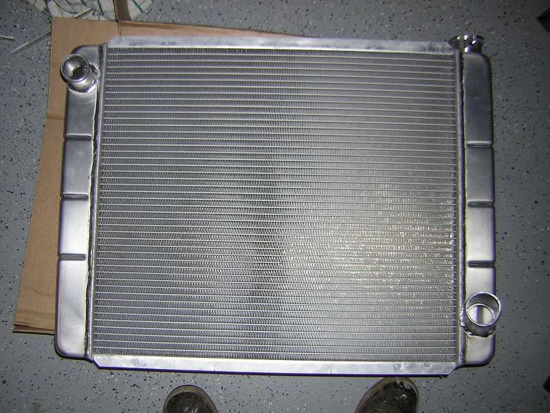

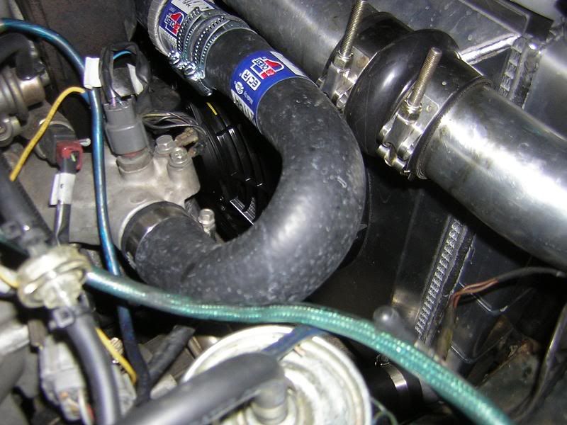

Well its been a while since Ive updated things. I just got a radiator kit from Summit Racing today and it looks like its up to the job of keeping my RB cool. It was a good buy too got a Radiator, Fan, Shroud, Radiator Cap, Thermostat and relay and all the necessary mounting brackets for only $450 bucks. I just have to modify the inlet so that it matches up to the RB set up. A good friend of mine has a Tig welder and extensive knowledge of welding so it shouldn't be a problem.
  • 2 weeks later...
Well the radiator sorted out all the cooling issues. I took the car out for a long ride today and it never got into the 190s even in traffic. The performance of the car even felt better and there are zero leaks. I'm very impressed with this from this kit from Summit Racing.
