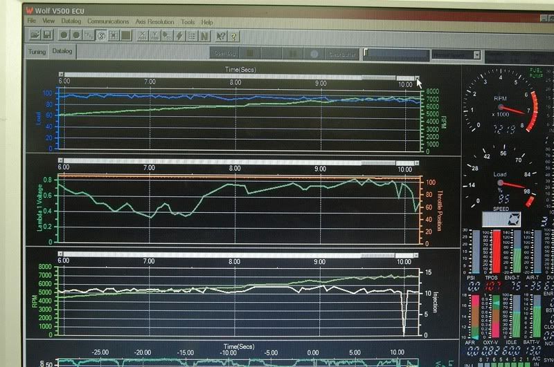

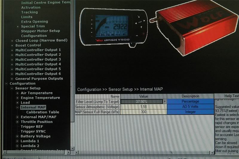

The electronic filter setting for the internal map sensor as sent with the Direct Fit V-500 for the VG30DETT has an incredible amount of filtration, which is not what I would’ve expected for a relatively modern 6 cylinder. (This is installed in a N/A Z-32, bone stock VG30DE). I would’ve guessed it to have a smooth stable MAP signal. Apparently my guess was entirely incorrect. Wolfs suggested starting value for the MAP filter setting, when starting from scratch for most engines is 93.75%. As shipped to me, it is set at 37.50%, which is a LOT of filtering! In looking at my data logged MAP signal, I can understand why! The VG30DE does not have a smooth MAP signal at any RPM and/or load.
With the VG30DE/TT's twin plenums, I could understand if the MAP signal is pulled from one plenum, generating a pulsating MAP signal, but at the balance tube the joins both plenums? I originally used the balance tube for my MAP signal, then switched it to one of the plenums. No noticeable difference in the logs between either location, both produced the spiky MAP signal in the pics below regardless of location.
Here are 3 pics, one of the filter setting, the other 2 are a WOT run through 2nd gear tonight, one pic around the 3000 RPM mark and one at the top end of 7200 just prior to engaging the rev limiter. Oh, and the WOLF Rev Limiter is oh so butter smooth. Power just falls on its face softly, no bucking, surging, no popping, etc. WAY smoother than the later OE higher bit rate OZ-32 rev limiter.
MAP trace is dark blue, upper graph.
