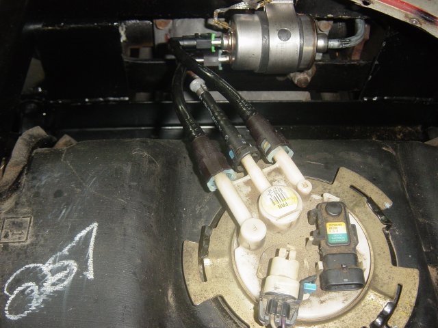

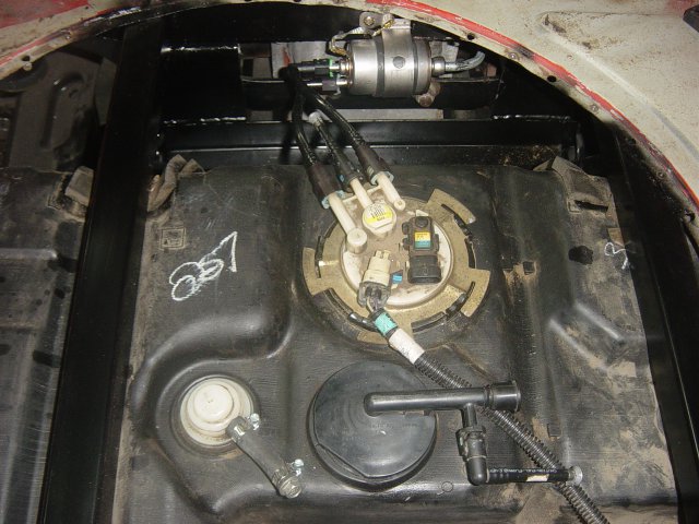

dtaylor Posted July 8, 2008 Share Posted July 8, 2008 Well After looking for to long for GM fuel lines I desided to buy the kit to make my own. Aybody else want/need lines made for there project? Here is a picture of my install.. Quote Link to comment Share on other sites More sharing options...
ragefear Posted July 8, 2008 Share Posted July 8, 2008 ha! that looks pretty clean! Sweet! So, I take it that its a GM tank and is that a charcoal filter they are going into? Am I mistaken but is that a returned system? What is that from? thanks. Sorry for the "post jack" I haven't gotten my car together yet and have TONS of questions! thanks! Quote Link to comment Share on other sites More sharing options...
dtaylor Posted July 9, 2008 Author Share Posted July 9, 2008 The fuel tank is from a 2000 Trans-Am. The lines run into a Corvette fuel filter/regulator.. Quote Link to comment Share on other sites More sharing options...
