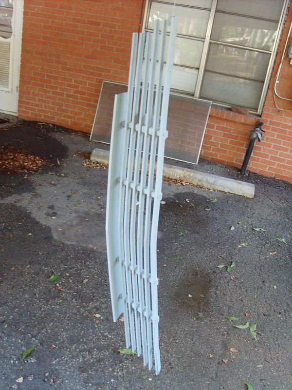

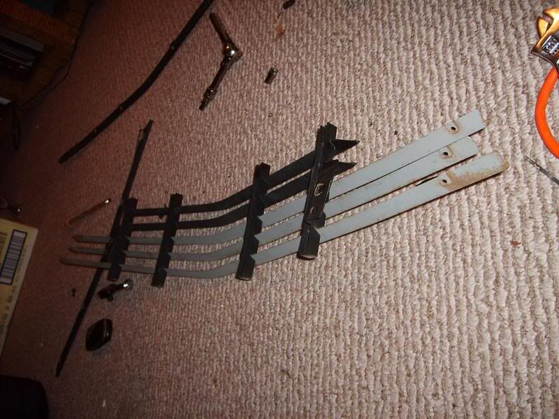

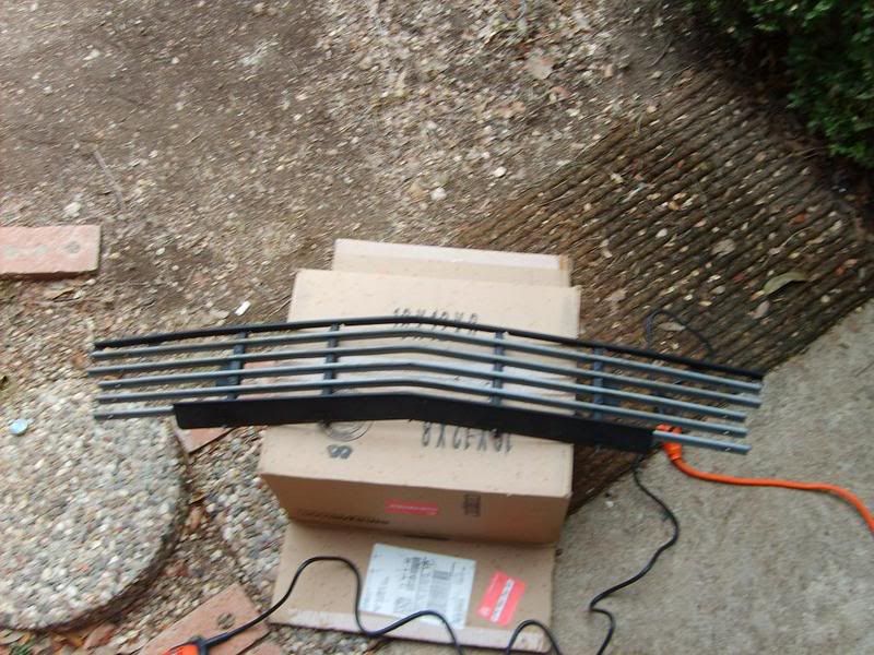

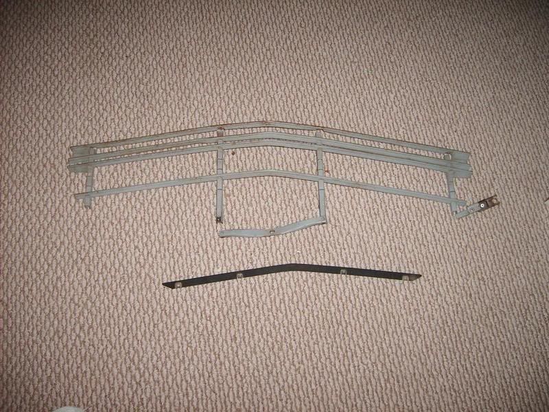

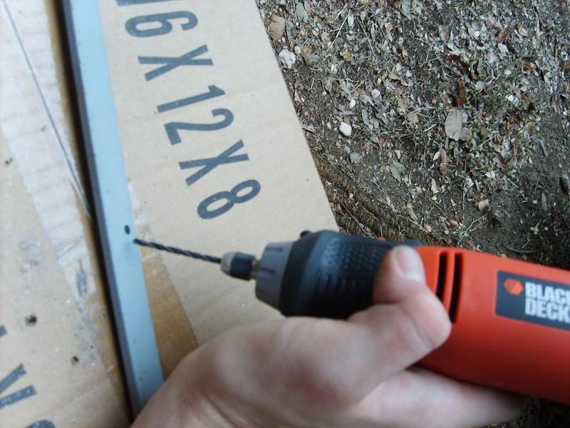

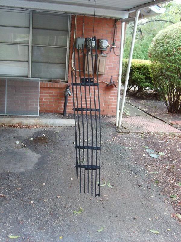

COmputoman Posted August 20, 2008 Author Share Posted August 20, 2008 So after taking a better look at what I was dealing with, it was realized that by disassembling both grilles I was able to use the cross slats from the 240z grille in place of the shorter slats. Only moddification that was required was 2 extra holes to be drilled on each slat to compensate for the extra mounting points. Here are some pictures Here is a picture of the 240 grille with a piece of the 260. You can see where the last mounting holes are not present on the slats from the 240 grille. half way assembled Drilling Grille assembled and ready for paint RustO! Primed and ready for paint Finished Quote Link to comment Share on other sites More sharing options...

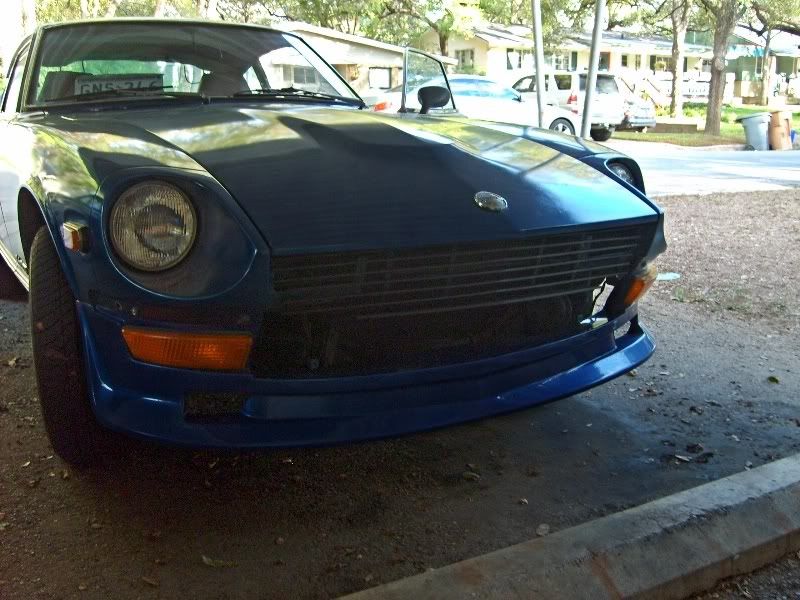

COmputoman Posted August 22, 2008 Author Share Posted August 22, 2008 Quote Link to comment Share on other sites More sharing options...
JSM Posted August 22, 2008 Share Posted August 22, 2008 Looks much better. The driving light idea I liked, but this works too! Quote Link to comment Share on other sites More sharing options...
COmputoman Posted August 22, 2008 Author Share Posted August 22, 2008 I was even thinking of having rectangular driving lights mounted behind the grille. That would be interesting. Quote Link to comment Share on other sites More sharing options...
DavyZ Posted August 23, 2008 Share Posted August 23, 2008 I was even thinking of having rectangular driving lights mounted behind the grille. That would be interesting. Looks better now. Driving lights behind the grill keeps them out of sight, yet right there when you need them. Good work! Davy Quote Link to comment Share on other sites More sharing options...
