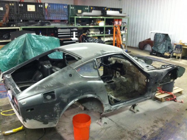

OK, I have the car completely stripped. Everything is off. Wiring harness, steering column, panels, suspension, carpet, etc. I am planning on doing Bad Dog and Zedd parts to get the frame rails and floorpans replaced first. After this comes replacing the quarters and back panel with California takeoff quarters and an MSA back panel or something else instead. The MSA panel is not 3D curved, but rather just 2D curved; it doesn't curve from one side to the other. I may look into a metal working tool to fix that. I don't know yet.
I am still a bit unsure on the floorpans and frame rails procedure, but I have an idea. Here is what I am going to do:
- Jack the car up level on a wood beam on the moustache bar mount points and another sitting under the front subframe mounting points on the front frame rails.
- I will leave the seat mount points in to retain trans tunnel to rocker panel dimensions.
- I know people say to put the trans mount in as well, but mine has been cut out partly to necessitate an RB swap. The reinforcement that the trans mount bolts to fouls on the trans somewhat and the speedo sensor is entirely fouled by the reinforcement. I will instead weld a bar across the area instead.
- Take some measurements to line up the frame rail laterally and perhaps make some marks at the front and back of the car to run a string for rail centerline, etc. Take some measurements for span between rails.
- Having done that, I will cut one side out. Frame rail and floorpan both.
- Weld in the floorpan.
- Weld in the frame rail.
- Repeat with the other side.
I know the front has been hit and one front frame rail seems to be bent right at the front subframe mounting point. I have not decided if I want to replace those, or just leave it as is. Either way I will install reinforcing tubes and plates for the swaybar mounts.
For reference, as of Feb. 2014 the Zedd Findings floor pans (which come from Canada) were $260 plus $69 shipping and the Bad Dog 280Z Frame Rails were $230 for the pair including shipping.
As you see in the picture, there is a lot of bondo in the back end. It seems that the back panel was smashed up quite a bit and had the rear end 'shaved' by welding everything together and filling with bondo. There was at least 1/4" or more in a lot of places. The right side wheel well had sections gone from rust. They ground the rust off and then filled it in with bondo. In that area, there were two spots that had max depth of 3/4" of bondo. Fortunately I got a set of quarters (not just quarter panels) from a California car that someone was scrapping out by cutting the car in sections with a sawzall. :-) I just need a rear panel if anyone had one as the ideal solution.
