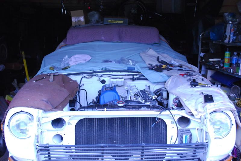

Right now just waiting on the weather to clear to pull the old engine and get the engine bay cleaned up a bit before putting in the stroker.
I will keep you guys updated.
Well today got the old engine pulled. Only took about an hour to do it which was a bit surprising since this was my first ever engine pull in my life.
The engine bay looks so empty without anything in it. We used a ratcheting tie down strap to support the transmission.

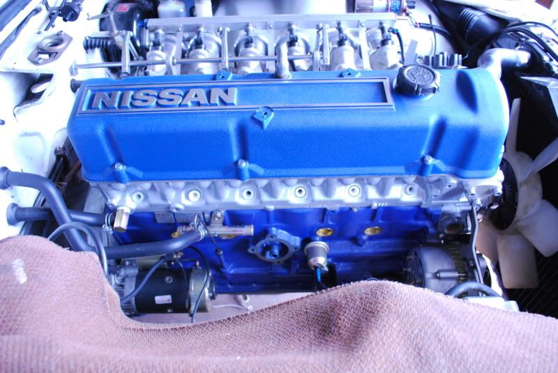

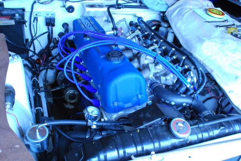

Got the motor put in yesterday!!!!
Now just have to start putting the bits and pieces on it.
It's finally coming together!!!

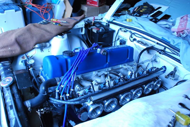

Getting most of the pieces put on the motor. Now I'm looking at fuel options. So far I've gathered that the stock 3/8" feed line will probably be ok and I was thinking about switching out the stock 5/16" return line for a 3/8" return line.
Also switching to a Walboro GSL-392 pump and was planning on using Earl's -6AN braided lines everywhere else (from the hard lines to the rail, rail back to hard lines, pump to hard lines, etc.) and using the Aeromotive A1000-6 regulator with guage.
I was planning on mounting the FPR on the end of the fuel rail and then coming back from there.
so basically: ~~= SS Braided, --= SS Hard
Tank~~~~Filter~~~~Pump~~---hardfeed---~~Filter~~~~Rail, FPR~~~~---hardreturn---
If anyone has any suggestions/criticism/whatever let me know as this is just what I've gathered so far and I am open to comments/help.

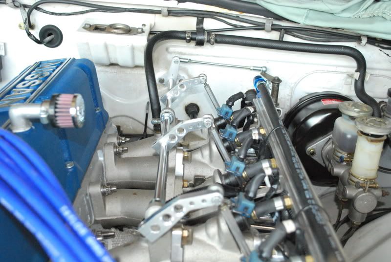

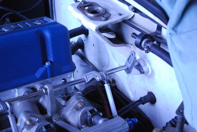

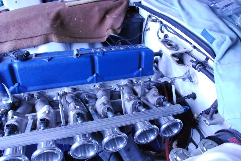

Here you can see what I did with the throttle linkage and rod.
I got a longer stainless steel rod to push it all the way to the firewall and then custom made the aluminum piece on the firewall so that the shaft wouldn't flex.

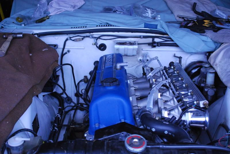

Nice side view of the ITBs, the header, and the Kameari distributor

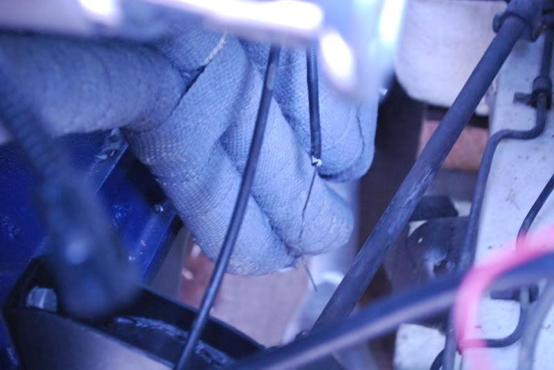

Close up of the header. Wrapped in DEI heat wrap and sprayed with their silicone coating. I am thinking about switching to the Arizona Z Car tuned header because it has a bolt on connector on the exhaust side and is 2.5" whereas this pacesetter (crap!!) header is only slip-on and 2.25".

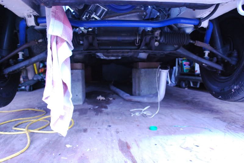

And just for kicks here is a shot of the underside. You can see the old exhaust sitting on the ground. This will hopefully be getting replaced with a SS 2.5" exhaust. Still haven't decided on a muffler.

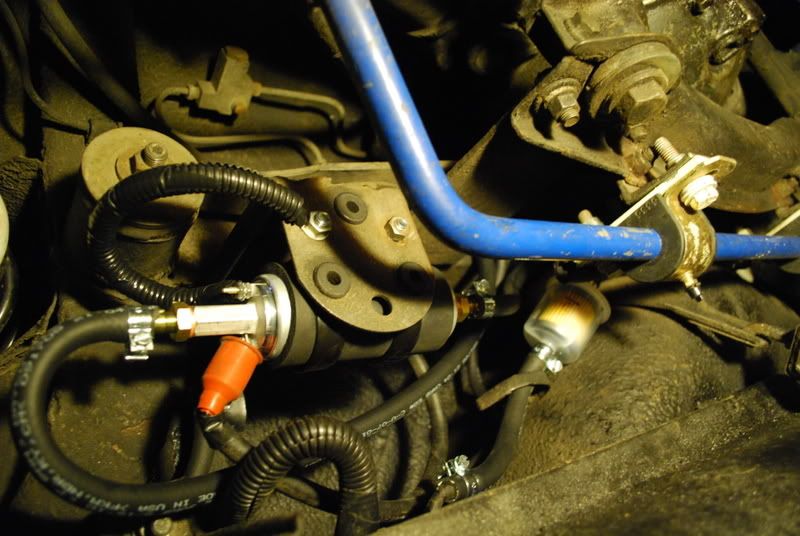

Pump and pre-filter installed near the tank.
Fuel lines ran to the rail. Installed a Fuel Pressure gauge between the second filter and the rail. Found a metal filter that had the same bends in it as the old plastic FRAM I had on the right. This pic is before I replaced the linkage. Also you can see I installed a breather filter for the valve cover and the PCV pipe on the side of the block.
Here you can better see the fuel gauge and the fuel filter. After this pic I installed rubber insulated clamps to hold the fuel hoses to the front of the block.
New throttle linkage. These are aluminum as opposed to the original stamped metal. Reason i replaced them though is because I over tightened one of the linkages and it snapped. Better now than when I'm driving.

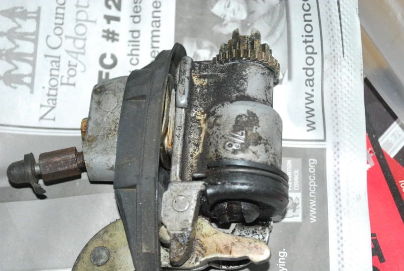

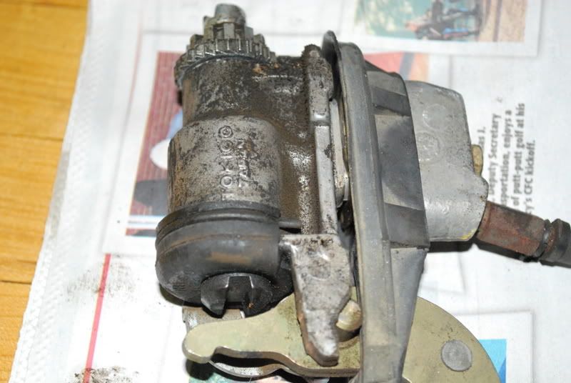

The old wheel cylinders. The one in the bottom pic had leaked so it needed replacing and I rebuilt it so I would have spares. The other one was fine so I just cleaned it up but I still replaced it.

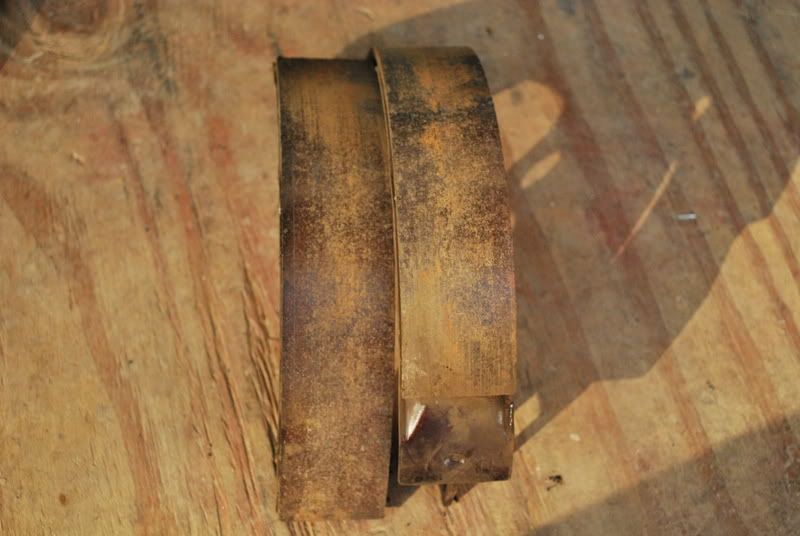

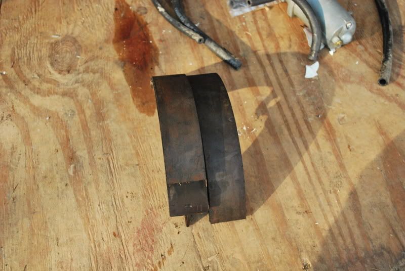

The old brake shoes. Notice the ones in the bottom pic are darker? That's because they are soaked in brake fluid. Sucks because there was still a good amount of pad left.

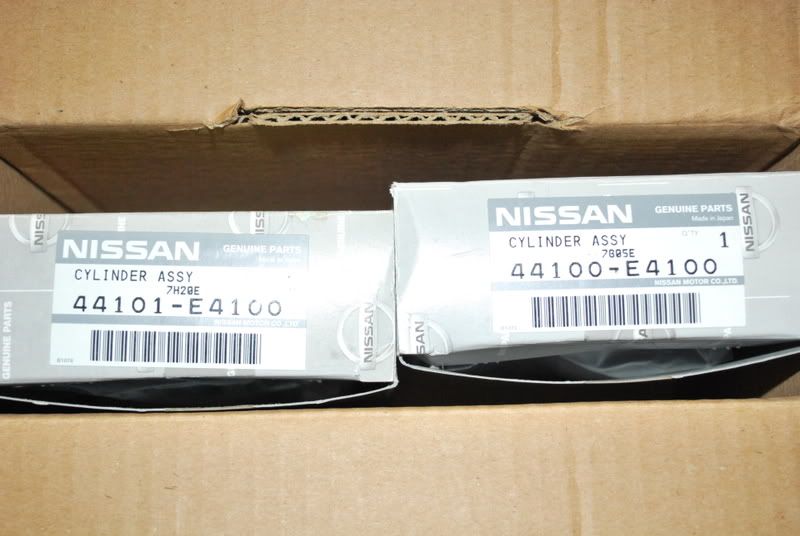

New wheel cylinders from Courtesy Parts. Nissan does still have a supplier for these for now....

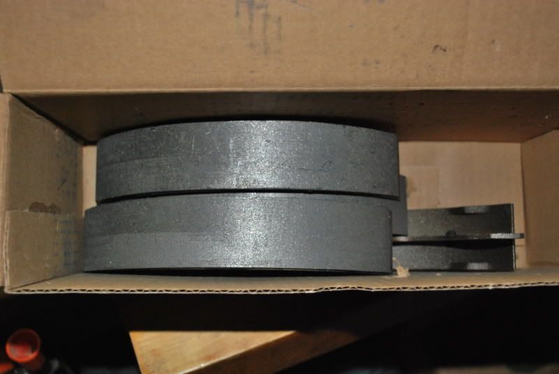

Metallic brake shoes for the rear from Motorsport Auto.

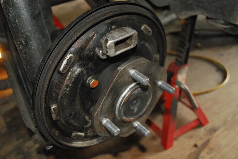

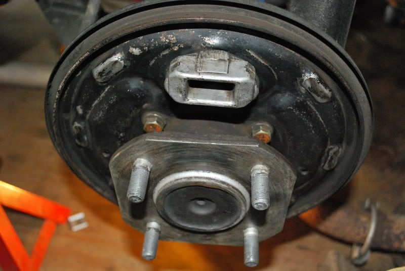

Both sides all cleaned up and ready for new hardware. Sorry I don't have any pics of everything installed.
