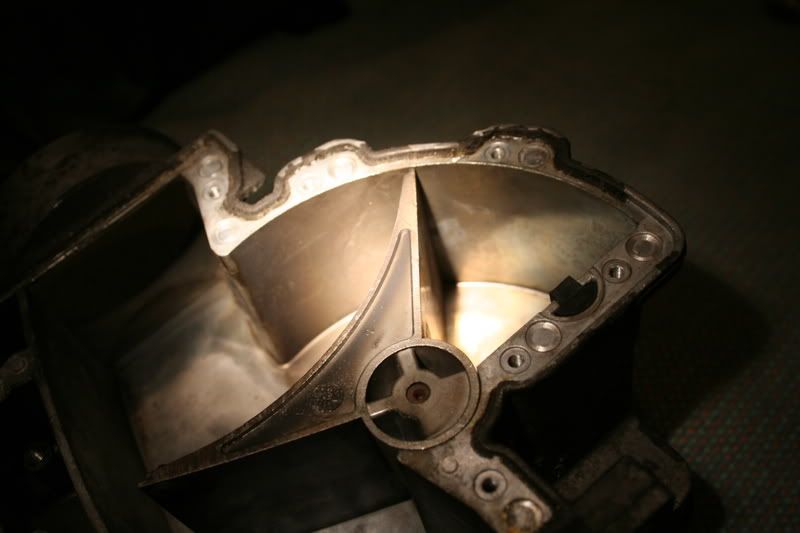

Not to debunk the advice that Wizardblack provided me with, but I had already tried spraying PB blaster to try and break up the gunk on the hinge, and even worked it back and forth for about a half hour with no progress! The back plate screws were all very tight and painted in to the surface, so warily i used my dremel to cut slots in them so I could use a flathead screwdriver. This is what I found.
a closer look

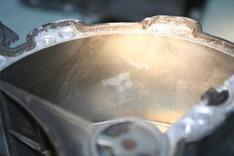

See that little bright spot in the center? that's where my flap was catching. The upper portion of the flap as you can see runs very close to the casing of the unit. Somehow the metal had deformed and was ever so slightly bulging in and catching the flap. The method I used to find the exact area was to shine a small surefire flashlight behind the flap as I moved it. So I got out my favorite toy: The dremel. For this I used one of the standard cylinder shaped sanding tubes and a steel wire rotary brush.
I did not have an extra hand for taking in progress pictures of my sanding (I don't even have a vice) but the method I used was simple. I set the dremel to 15000rpm and made even flowing motions to sand out the problem area in the direction of the flap's travel. Don't go too slow or linger in one area too long, or you'll end up with an uneven surface.
This is the finished product

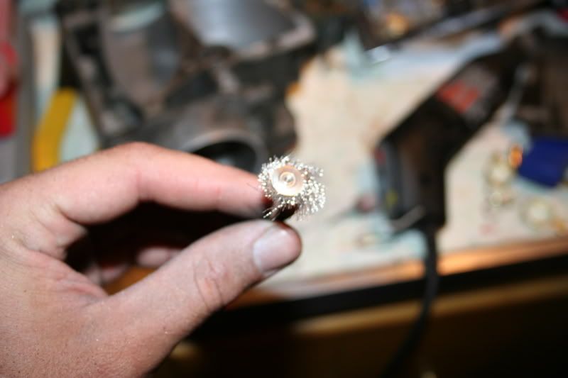

I then used the wire brush tool to smooth things out a bit more.
Then I got carried away and commenced making everything shinier.
End product: one worn sanding drum and a scraggly looking wire brush. I highly suggest wearing goggles during this operation, as little wire bits will be flying at high velocity in all directions. For that reason you also shouldn't operate the little dremel brushes above 10000rpm. This is why the next step is picking the wire bits out of your arm...
Use some air to blow out all the metal particles and you're done! Test the flap to see that it moves freely, and repeat sanding if necessary. Try to limit the amount you shave off to just the right amount of clearance for the flap.
The process should take about 15 minutes with a dremel, a bit longer if you were feeling froggy and did it by hand.
