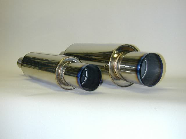

jakeoster Posted September 11, 2008 Share Posted September 11, 2008 Problem: I am going to invest in a genuine HKS Hi-Power Ti Muffler and I am not sure if I should get the 120mm tip or 96mm tip. Question: Does a larger diammeter tip yeild a larger horse power gain or does it have a point of diminishing return? Which muffler would yeild the biggest horsepower gain? Application: RB25 powered 280z. Supplementary Info: I do not care if the larger muffler looks ricer, were not dealing with a Honda Civic here. I do not care if the larger one costs more because its not much more. I want my car to sound bitchin:biggrin: Photo: Quote Link to comment Share on other sites More sharing options...
Guest 280ZForce Posted September 11, 2008 Share Posted September 11, 2008 what you should be considering more so is the inlet diameter not the outlet. inlet sizes of each respectively? is your rb25 n/a or turbo? Quote Link to comment Share on other sites More sharing options...
m4xwellmurd3r Posted September 11, 2008 Share Posted September 11, 2008 that's what I was going to say. I would think it would be more important for the inlet and outlet sizes to be the same size as the rest of your system. Quote Link to comment Share on other sites More sharing options...
jakeoster Posted September 11, 2008 Author Share Posted September 11, 2008 Approximately 3" for the inlet on the larger one and the smaller one has an inlet of about 2.3" its a turbo'd RB25. Also I do not have an exhaust system at all, just the header coming off the turbo. I am going to fabricate my own piping. I apologize for the lack of relevant information. This may sound like a dumb question but whats with the sideways muffler mounting? Any performance value from this? Since I'm making my own piping I want to make it as performance oriented as possible. Quote Link to comment Share on other sites More sharing options...
m4xwellmurd3r Posted September 11, 2008 Share Posted September 11, 2008 for a turbo I would think a full 3in setup from the turbo to the muffler would be the best route. Quote Link to comment Share on other sites More sharing options...

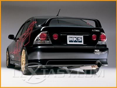

73DatsunZ Posted September 11, 2008 Share Posted September 11, 2008 This may sound like a dumb question but whats with the sideways muffler mounting? Any performance value from this? Since I'm making my own piping I want to make it as performance oriented as possible. I have heard its because when people are running a boosted car, they want to have the least amount of bends in the exhaust so it will flow better, and sometimes it ends up coming out like that. I guess there may be a small gain, but nothing noticeable I'm sure. But most of the time I think its for looks Quote Link to comment Share on other sites More sharing options...
jakeoster Posted September 11, 2008 Author Share Posted September 11, 2008 ohh ok. I don't think I'll bother with the sideways mounting of the muffler. Thank you. Quote Link to comment Share on other sites More sharing options...
