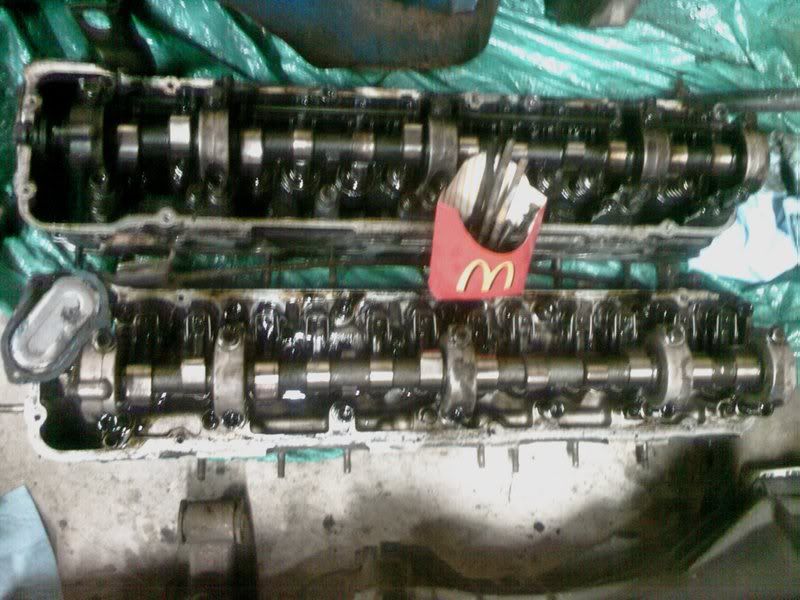

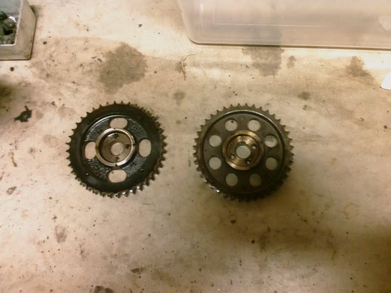

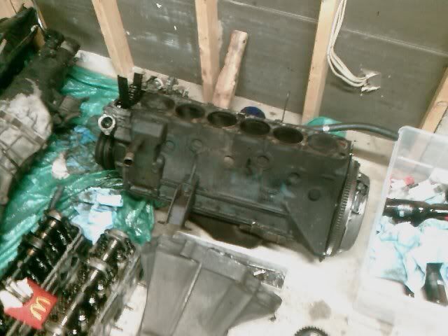

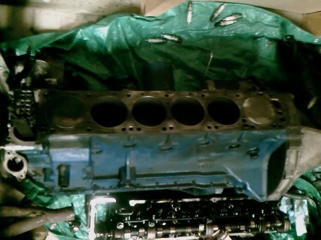

Here are a few pics of the donor motors. The dirty one is the one that the N42 came off of. The clean(ish) one was rebuilt a few thousand miles ago, but the head gasket blew (probably because the PO drove it like his @$$ was on fire) and thats when I came to own it. Now about the cam gears... I've never see one with more than 4 holes. That one was on the rebuilt P78 head. Is this stock for that head?
An N42 head with flat top pistons will likely have detonation on pump gas. When I first put that combination (N42 head and flat top pistons) together BRAAP warned me that it was likely to have detonation and that the benefit of the higher compression would be more than offset by the loss due to retarding the timing. Even with bigger cam I had to retard timing to around 20 degrees. I could feel the torque fall off as the engine RPMs pulled through the band where I had the timing pulled back.
Is there something wrong with the P79 head that causes you to want to switch to the N42? Otherwise, why not put it back together with a Felpro gasket (1 mm)? That will yield a CR of 8.7 and you can run with full advance.

The cam gear is just an aftermarket piece, nothing special. It was probably replaced during the rebuild.
You might want to check the head with a quality straightedge to make sure it isn't warped.
Personally, I'd stick with the P-79 after reading through all of the cylinder head discussions on these boards. If you wanted more compression it could be shaved, the cam towers shimmed, and different valves installed. That way you keep all of the "quench" capability which is supposed to help ward off detonation.
