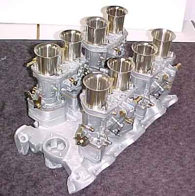

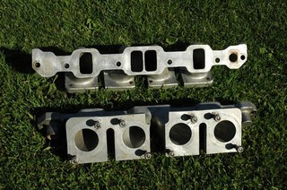

How common are they in the pick n pulls and junkyards over stateside? I'm looking for one to fit a Hilux with a toyota 3y-j engine but got to thinking about a quad set on the rover V8 I have. like the pics below:

The last couple wouldn't be too difficult for a decent engineering shop to copy, with a inlet manifold to copy a flange off and the bases of the carbs to make a flange off, then just bend and weld some tubing for the runners.
But downdraft twin throat carbs aren't that common here, the ford pinto wasn't sold in NZ and the other good source for them, the 60-80 Fiats ditto.

...but to answer your question further, it sounds as if you're looking for a Weber DGAV, which is not the same beast in your photos. Those are Weber IDFs or IDAs.
