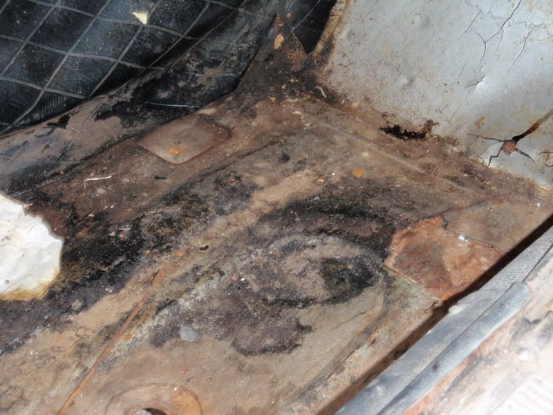

Floor pans are in surprisingly good shape, probably going to be stripping it down to bare metal to make sure there is no rust, but right now it looks like I have a pretty decent chance of it being very LOW rust.

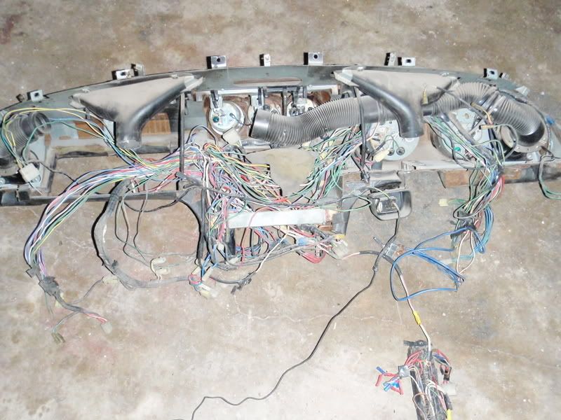

Old dash, I can see why the car was not running. There were wires going everywhere, things spliced together in 2-3 different places with random switches and stuff thrown all through out entire dash wiring.

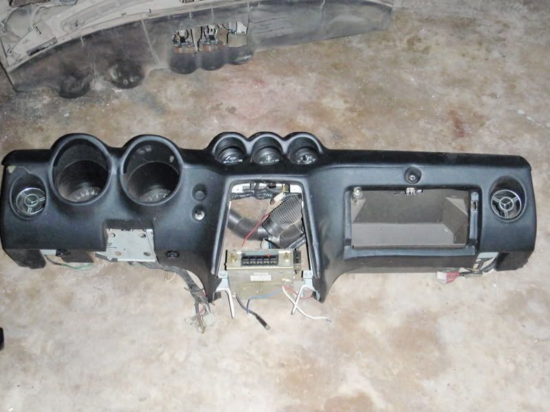

New dash, all the wires are still in what looks to be their factory places with the coating still around them. I think that these are the same time period dashes due to the similarities. It doesn't have the little cut out by the switch. Any chances that my original dash and the dash i bought with the car are the same??

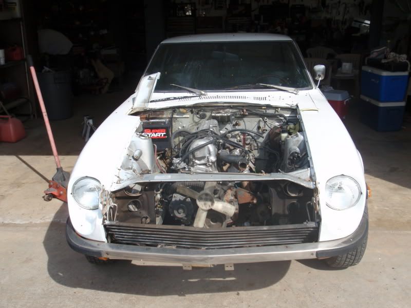

Hood off:
Engine out:

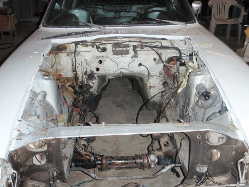

We had the motor out in about an hour maybe two hours tops. This wasn't my first engine removal but it was my first on a RWD car. It is a lot easier to work on a RWD car than a FWD car, espically this one. Everything went really smooth. I forgot to get pictures of the motor when I pulled it but I will take some next weekend. Next weekend I am planning on pressure washing the entire underside of the car and engine and trans, repaint block, and then a full gasket kit. Depending on the clutch condition I may replace it as well. After the engine bay drys I will be going over it with por15 to get the few rust spots there are. Things are coming together, as soon as it is running and moving on its own power I will be moving to suspension/brakes (new bushings, install aftermarket struts and springs (can't remember brand at the moment), maybe purchse a set of toyota 4x4 calipers and rebuild them and probably replace the rear drum stuff too (If I can't figure out a rear disc conversion by then, would rather go this route than using drums just for general looks and stoppping power, discs are far superior in my book) then I will be moving to the interior.
