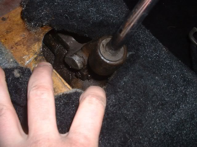

MetalThrashingMad Posted February 12, 2009 Author Share Posted February 12, 2009 OK, here's a picture of the linkage. I hope it's clear enough? Quote Link to comment Share on other sites More sharing options...
blue72 Posted February 12, 2009 Share Posted February 12, 2009 Looks like that's the F4W71-A, or "monkey motion" style original 4-speed transmission then. Someone else will have to chime in because I haven't played with the bushings or linkage on this style of trans yet. Quote Link to comment Share on other sites More sharing options...

Administrators BRAAP Posted February 14, 2009 Administrators Share Posted February 14, 2009 Yeup, early Monkey motion style. With it exposed as you have it in the picture, move the shifter around. If it is moves excessively in the cast piece, either your rubber bushings are worn out, gone, or the nut on the bottom is loose. On the bottom of the shift lever will be the nut, in front of and underneath your index finger in the picture. Verify it is tight. Hope that helps, Paul Quote Link to comment Share on other sites More sharing options...
MetalThrashingMad Posted February 14, 2009 Author Share Posted February 14, 2009 I actually mustered up some ambition and went out and troubleshot/fixed it today. 1) There is a pin with a C clip on the and and that pin was worn out, loose and too big for the hole. I got a bolt and some lock washers, double nutted it and tightened it to ♥♥♥♥. It's great now, hopefully it doesn't wear out or loosen up. It's all metal to metal and rather tight so I'm a little wary of it. This accounted for about 90% of the play I had. 2 and 3) There's 2 tapered rubber bushings in there that were worn out. I put a particular size rubber washer on the top bushing and tightened it up. Perfect. Conclusion: Washers fix everything Quote Link to comment Share on other sites More sharing options...
