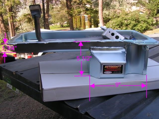

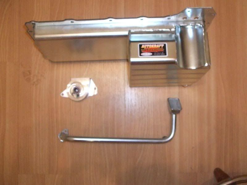

Administrators BRAAP Posted December 4, 2009 Author Administrators Share Posted December 4, 2009 (Gonna keep this thread alive, only because it had so many followers) ... NOW, let's talk about the Autokraft pan. BRAAP....do you by any chance have the measurement for that pan? ... I certainly do. I talked with Kurt of Auto Kraft about his oil pan when researching pans for the Z32 and this is the info he gave me; ... The depth of the pan measures 1 3/4 forward of the sump. It is 5 1/2 inches deep at the sump Rear of sump to front of sump is 9 inches 5 1/2qt capacity ... http://www.autokraft.org/products/ Hope that helps, Paul Quote Link to comment Share on other sites More sharing options...
