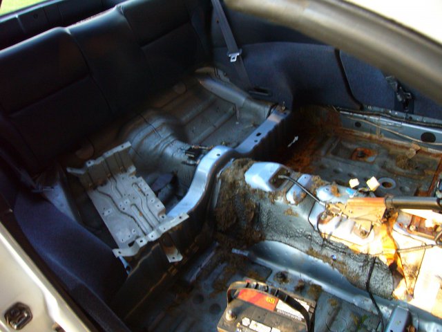

chris51881 Posted May 27, 2009 Share Posted May 27, 2009 (edited) so far we stripped out the interior Edited May 27, 2009 by chris51881 adding more photos Quote Link to comment Share on other sites More sharing options...

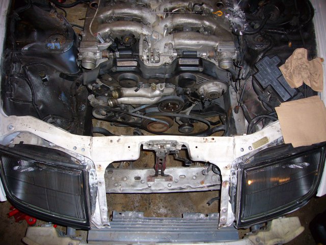

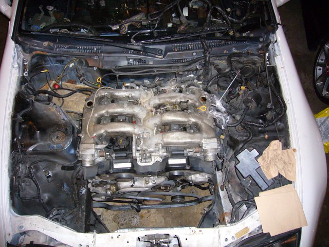

chris51881 Posted May 29, 2009 Share Posted May 29, 2009 today we got under the hood and removed a variety of parts. The front bumper and piece between the headlights came off too. here's a list of most of the parts that were removed: radiator and hoses, air box and intakes, electric fan, condenser, ac pump, all ac lines, power steering reservoir, power steering lines, fuel rail, injector plugs, and most of the harness plugs. Quote Link to comment Share on other sites More sharing options...
