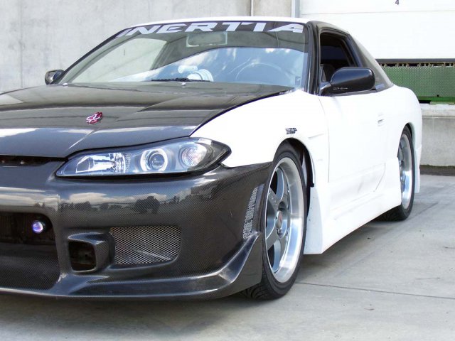

drift_inertia Posted May 29, 2009 Share Posted May 29, 2009 (edited) B-Road makes pretty high quality parts. I have used a few items from them on an fc3s RX-7 I owned. Carbon fiber is nice and strong and light. It holds up to rock chips very well just as good if not better then fiberglass. it also will not sag like poly items do. the only drawbacks to CF that I have found is A. when it is mounted securely it is brittle and a good hit will shatter it and it isnt repairable unless you want it painted. but when my brother had his c west cf s15 conversion on his s13 he would hit prking blocks and it would rebound his car off the block. and B. Depending on the clear coat quality it will eventually discolor and peel meaning you will have to wetsnd the hood and shoot it with a high quality clear.] hope that helps, Matt ps here is pic of my bros's s13 the fenders are the B-Road strawberry face s15 fenders very high quality Edited May 29, 2009 by drift_inertia added pic Quote Link to comment Share on other sites More sharing options...

AkumaNoZeta Posted May 29, 2009 Share Posted May 29, 2009 You could get the a flexible urethane one and thing have radiator ducting and a splitter made from sheets of aluminum to keep it from sagging and not to mention greatly improve aero. And Drift Inertia, that's a lot of CF, did it really bounce the car back after hitting curbs? How hard were they hit and how hard did they bounce back? Quote Link to comment Share on other sites More sharing options...

drift_inertia Posted May 29, 2009 Share Posted May 29, 2009 Grim, It is alot of CF lol As far as bouncing the car back, it never did it at speed, but we did hit numerous prking blocks nd curbs at anywhere between 1 to 8 mph and the car would literaly bet pushed back, the only damage that ever happened to the cf becuse of it was slight chipping and scratching of the clearcoat. CF truly is great strong material and there used to be a few videos of guys jumping off the roof of their house and landing smack dab in the middle of the hood and not cracking or shattering it. ( I wouldn't recommend it since any resin based product only has so much give before it starts cracking and fracturing) Quote Link to comment Share on other sites More sharing options...
AkumaNoZeta Posted May 29, 2009 Share Posted May 29, 2009 Thats trully amazing. I always thought of it being super brittle and easily shattered. Quote Link to comment Share on other sites More sharing options...
