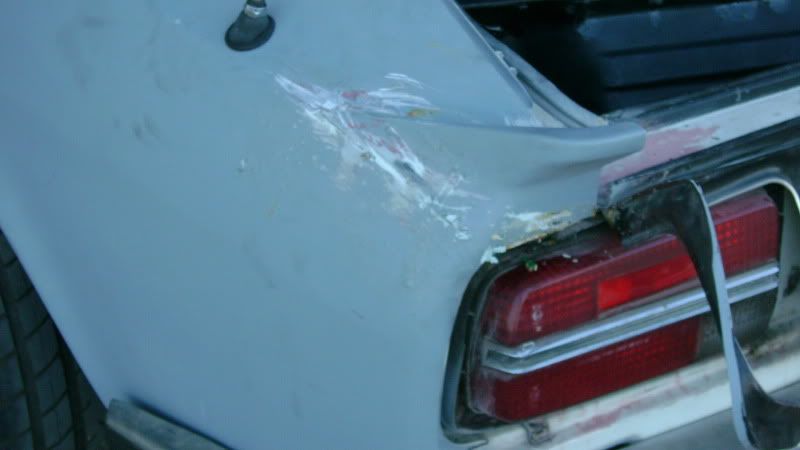

So what was supposed to be something as simple as a urethane spoiler removal, turned into a fender project to fix the install of the subtle z flares from the previous owner. (and i bought the car to avoid body work)

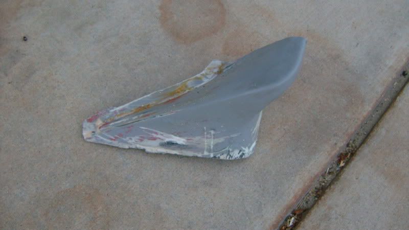

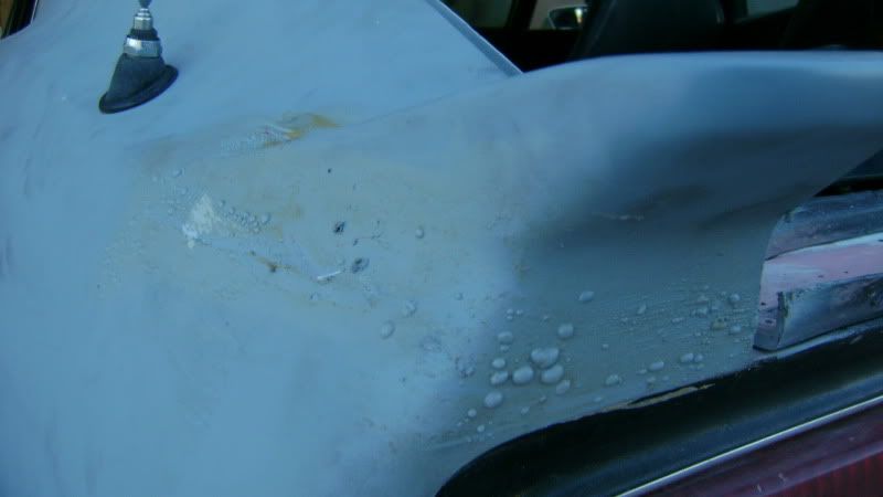

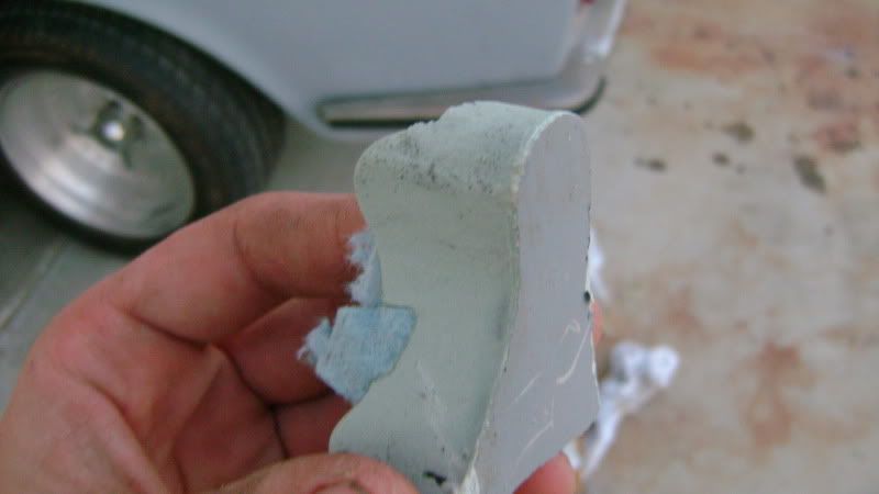

alright, a little paint stripper and its enough to soften the body filler enough to rip the spoiler end off.
then i thought that maybe the ends where held on by bondo and glue, so i started scratching and pecking my way through it with a screw driver and hammer!
and whalla! it popped off, after an hour!

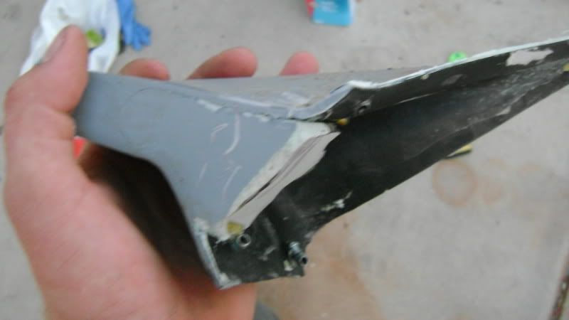

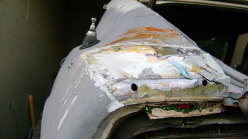

found some interesting things once that end piece was removed....

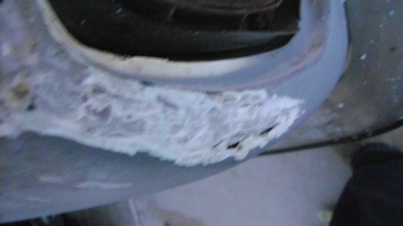

then i started to realize why the rear of my car never really looked sharp like the stock body lines of an s30.

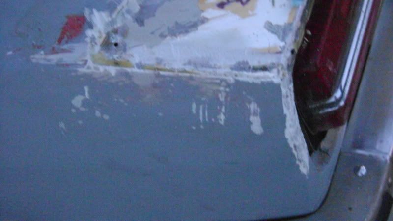

and yes, that jagged edge of grey paint you see on the right is actually the edge of the fiberglass, it appears then didnt even try to bond the fiberglass with the metal, they just riveted the panel in place and covered it with filler.
it wont look too bad bad, once the feners are cleaned and smoothed back to there original shape.
i guess i now have to drill out the rivets and start all over, should be interesting, I'm going to do it correctly though.
