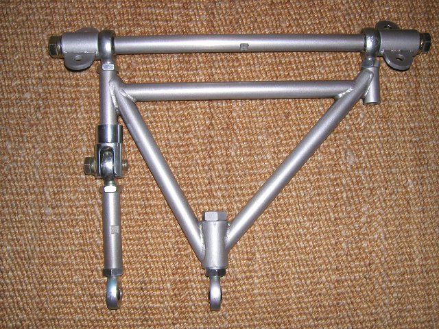

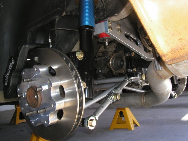

Mike Mileski Posted March 13, 2010 Share Posted March 13, 2010 300ZX TT R230 and hubs, Techno Toy Tuning uprights, axles and crossbrace, Wilwood calipers and rotors, JSK hats, my own rear arms. Mike Mileski Tucson, AZ Quote Link to comment Share on other sites More sharing options...
