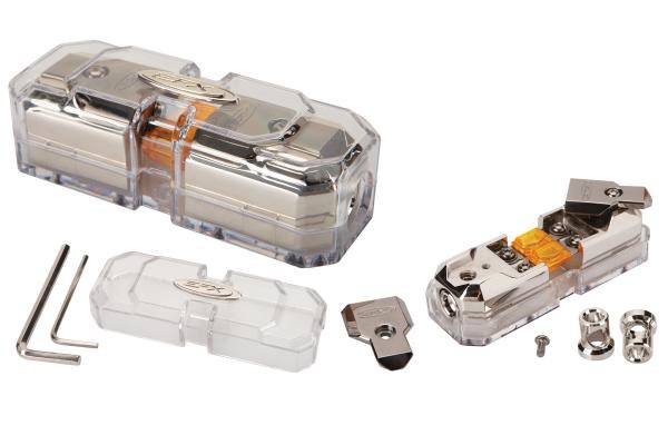

cruceno21 Posted April 1, 2010 Share Posted April 1, 2010 Reviving an old thread (new guy here). I have a 75 280z with just the one fusible link. Would it be easier since I only have two fuses to cover to do inline fuse blocks? Then I don't have to run a new wire from the starter to the block. Then I just remove the fusible link, and run the white wires into one side, the striped wires into the other side. For only having to do two on my car it would be faster and easier. Below is a sample pic, I got a local shop here that can get me two of these for less than 10 bucks. Then I throw a 40amp and 80amp fuse in there and am good to go. Quote Link to comment Share on other sites More sharing options...
galloguy05 Posted April 3, 2010 Author Share Posted April 3, 2010 Personally, I would go with the dual block and run the wire from the starter to it. The problem the fusible links has is getting the power back to the battery and the wire back to the starter helps insure that it does (I believe). If have the whole situation figured out correctly, then I believe if you run it without the wire from the starter, then it negates the purpose (for me anyways). Hope this helps. Quote Link to comment Share on other sites More sharing options...
