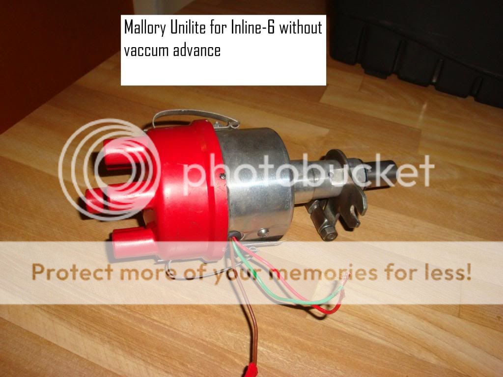

After buying a used I-6 mallory unilite - no vac advance - from ebay (I know), I opened the box to find that it does not spin.
I've been in contact with Lantoga, who sold this to me. He tested it on a SUN distributor testor before shipping it out. It was very nicely packed, and most likely not damaged in shipping. No cracks or fractures on cap or rotar.
When it was tested on the sun machine, the clamp that attaches to the aluminum base for the timing cover is not used; the machine has its own clamp. It passed the test, and was put back together to ship (to me). He believes that the problem is the bolt that attaches this clamp is too long, and I need to take her apart and loosen this bolt. If she spins freely after loosening, the problem would be a bolt too long. I have never taken a distributor apart from the bottom-up.
My apologies for not using correct terminology for the labeling of the dizzy parts; I've never taken one apart before.

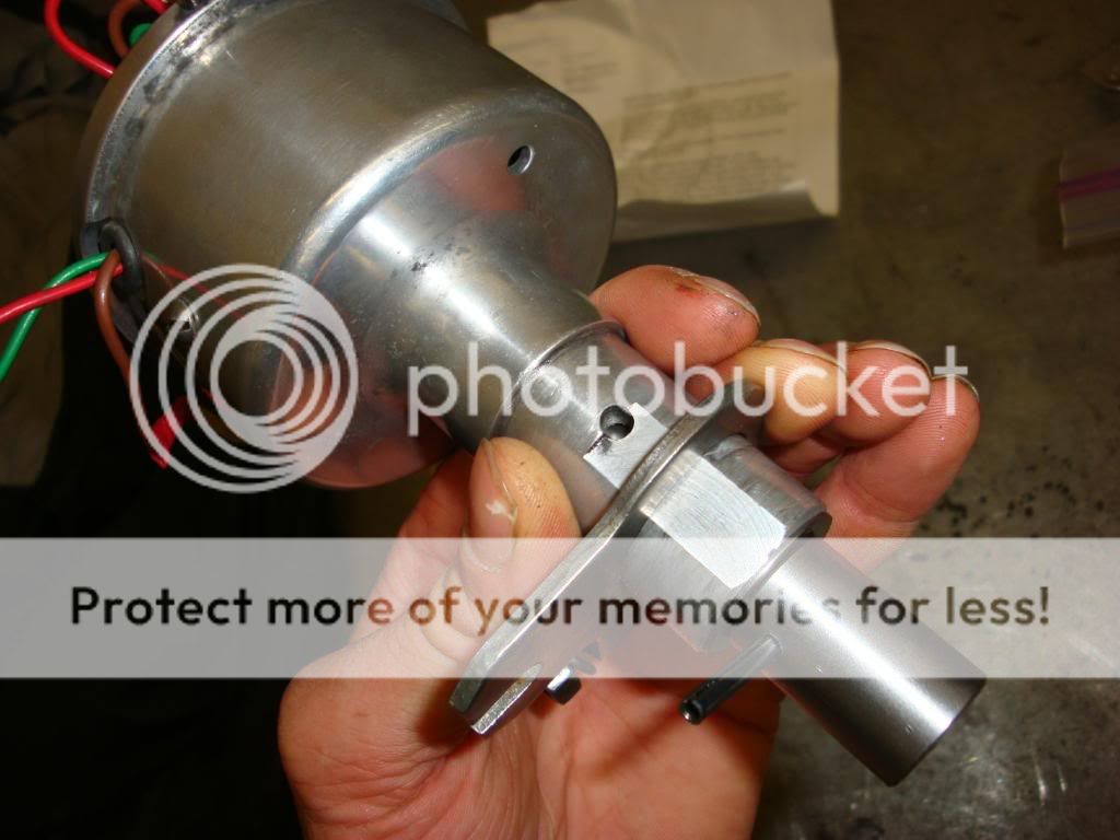

Below are some pictures of trying to get to this base... and to refresh your memory on this model:
Distributor:

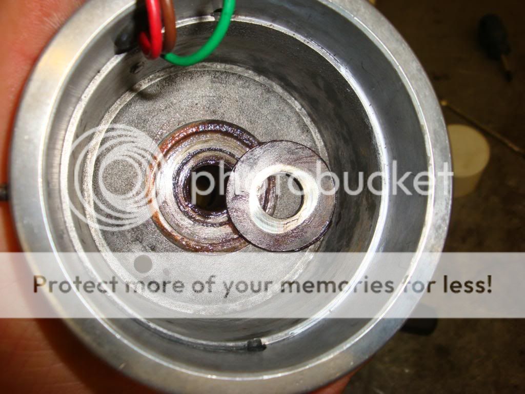

Rotar off:

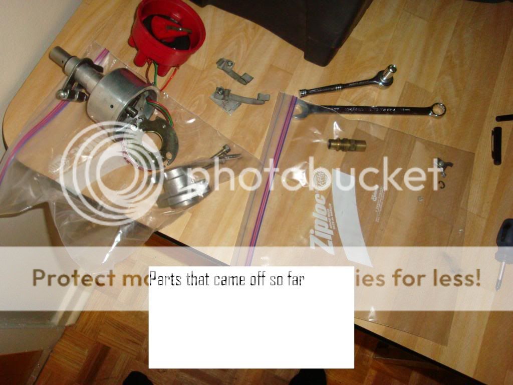

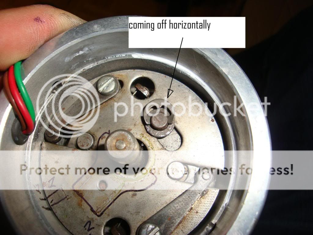

The furthest I've gotten:
After the clamp-washer that is coming off horizontally, I cannot get any further down. It is possible that the round washer that sits below it may be designed not to come off.

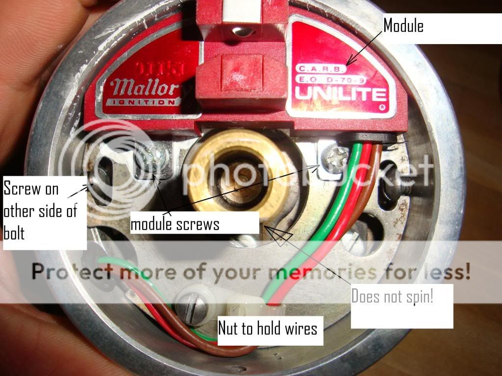

As it is now:
Thank you for any help in getting to this screw!

The top can be completly lifted out through the removal of the spindle pin (can be seen as a hole, beside the large base clamp, in the first picture). After not wanting to budge, I tapped the bottom of the shaft quite hard with a hammer, to break what was a rust seal on the inside of the shaft. Cleaned it up, put it back together, spins freely. I re-lubed it with graphite grease, though there may be a better type of grease to use. Graphite will not seize or clump. The rust, after cleaned up, was minimal.

Here is how to take apart and put back the unilite:
Spindle Pin removal: Use a flat punch, not one with a point
Base removal and washer orentation (slides down):
Clamp removal (loosen while mounted to adjust advance):

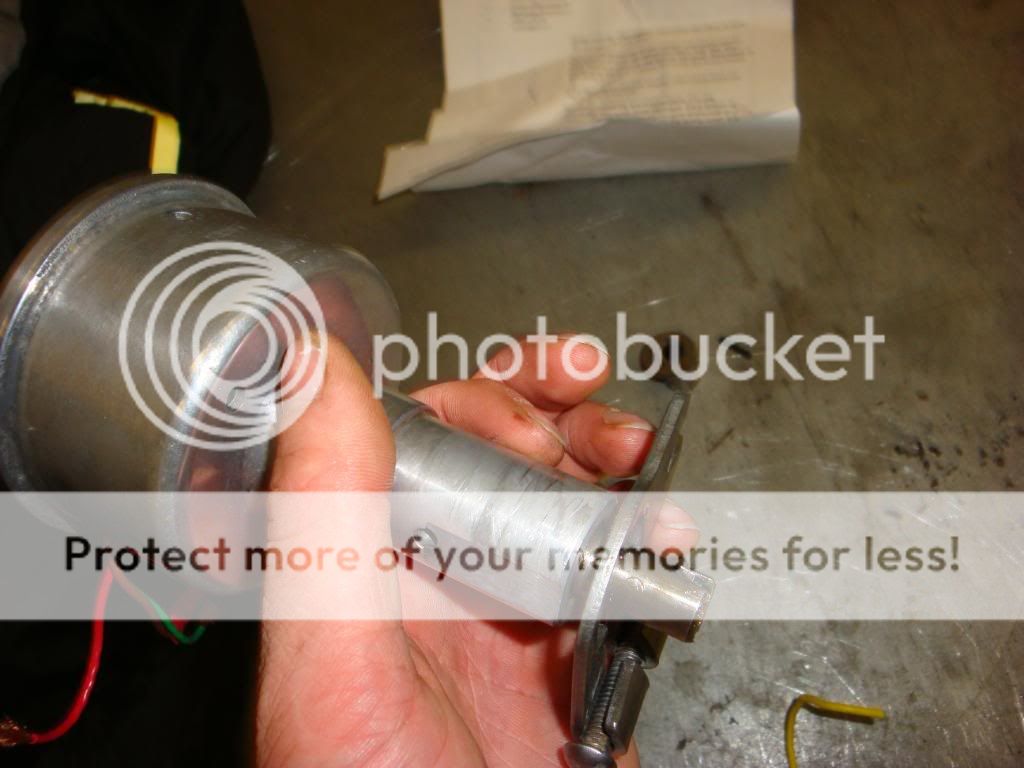

I had to tap mine with a hammer, from the bottom, fairly hard, to get this to push out the top:
5aftertappingwithhammer.jpg[/url]
The shaft has now come out the top:

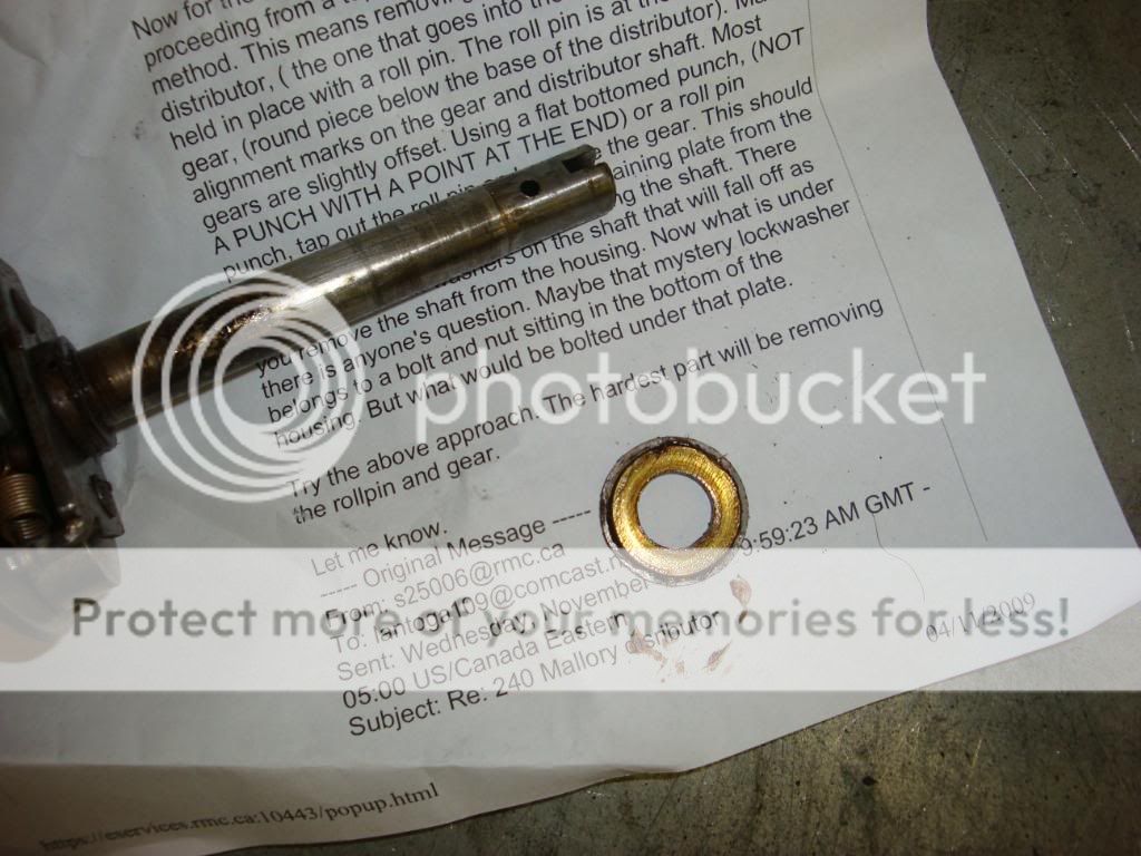

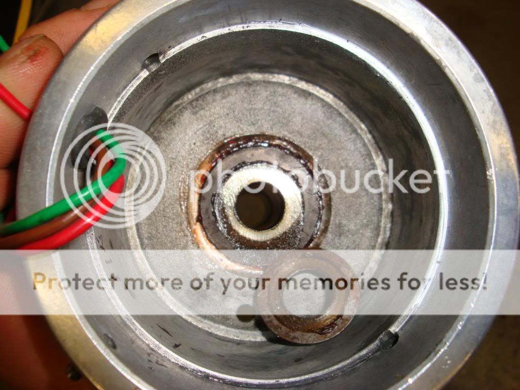

Washer orentation (has not been flipped)
Washer orentation (One just of the first two washers):
Yes, the background is the email from the seller. Very knowledgable.
There is one more washer below the above two. It's orentation looking down is:
That's it. No pictures of cleaning it up and puting it back together, I just used these pictures to do it.

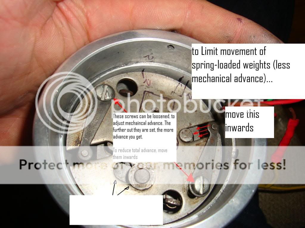

11. At idle, I now have 5* advance and the car will not start from cold (or get low-rpm peformance). To change this, we need to lower the ammount of mechanical advance inside the distributor. To do this, these screws need to be moved inwards, to limit mechanical advance:
Anyways, I'll get around to doing that tomorrow. I've had good results from 18* below TDC at idle. Hope this helps someone.
