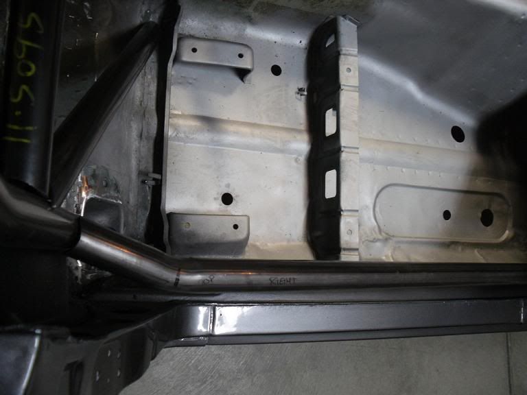

no....you are suppose to put the rust bullet onto the bare surface itself, not over the bed liner. either way, it acts as a protection and seals it in so no rust/moister can penetrate though. i used it on my panels and work the paint over it. its real similar to por15. i did it by using an disposable aerosol can and used acetone mixed so thin it out and spray it on. the acetone dries quickly and leaves only the rustbullet behind. it came out nice and smooth like if it was in a can! my floors with rustbullet/acetone mix coating...no primer!!! all rustbullet...
