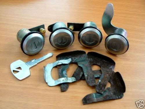

RB30X Posted January 14, 2010 Share Posted January 14, 2010 I have just bought a new lock set consisting of ignition barrel, two door locks as well as two extra door barrels, all key'd alike. I got the two extra door barrels for the fuel flap and the rear hatch. Now all I need is a picture of what the cams look like on the back of the barrels so I can make them up myself. The fuel flap is pretty straight foward but I am interested to know how the key turning the barrel in the hatch, pushes down the lever on the hatch release mechanism. So far all I've found is this pic which kind of shows a boot/hatch cam from a Dastun 510. Can anyone show me what a 240Z/260Z's hatch lock barrel cam/lever looks like? Thanks Quote Link to comment Share on other sites More sharing options...

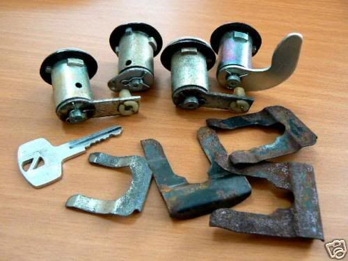

Mike kZ Posted January 14, 2010 Share Posted January 14, 2010 Like this: Quote Link to comment Share on other sites More sharing options...
DavyZ Posted January 16, 2010 Share Posted January 16, 2010 I personally don't like the button/hatch lock barrel thingie on the rear. I may just eliminate it completely from my car. The 510 lock may work if the 'arm' is swapped from the 240Z. This may be the simplest modification ever. Or, I may make a remote switch and weld sheetmetal over it... Davy Quote Link to comment Share on other sites More sharing options...
