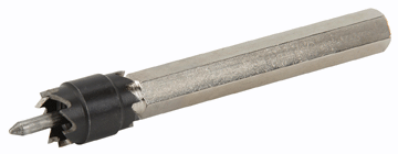

ritrebor Posted April 4, 2010 Share Posted April 4, 2010 I picked this up at harbor freight and it works on getting the spot welds off. ritrebor Quote Link to comment Share on other sites More sharing options...
z2go Posted April 18, 2010 Share Posted April 18, 2010 Drilling them with the above mentioned style drill is going to be your best bet, second best would be grind the area where the spot weld is down until it is thin enough to break off... you don't want to hit it with the chisel because those welds are kind of strong... you might warp and bend the metal behind it. For that matter, so will grinding if you go too fast. I'm curious, what do you have in your former dash area? A custom gauge box or anything? Quote Link to comment Share on other sites More sharing options...
burninator Posted April 19, 2010 Author Share Posted April 19, 2010 That drill bit would have been great. What I ended up doing was grinding several of the largest brackets that stick out the furthest off with an angle grinder. That worked okay, but took a long time and it was hard to get the grinder in several places. If a person had something lower profile like an air grinder it would be easier. You do have to be careful not to grind too fast or get too deep because it's hard to tell when you've actually ground through the bracket. Most of the brackets I just left if they didn't seem to dangerous. Right now I just have a couple switches mounted on a bent piece of aluminum. When I get around to mounting gauges I will just stick them on a metal plate or something. I'm not getting too fancy, it's just a race car and for me the simpler and lighter I can make it the better without getting to ghetto. I'm not going to win any shows with it, but it's functional. I'll post pics when I get a bit further so you guys can point out everything I did wrong. Quote Link to comment Share on other sites More sharing options...
