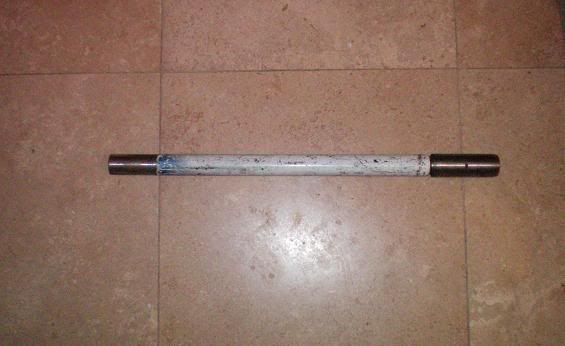

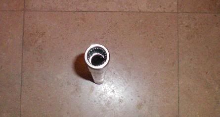

I just measured on my setup. From the base of the shifter plate to the top of the trans tunnel I got exactly 2''. Also if you want, I could send you my alignment tool to make sure your engine and trans is lined up with your diff.
I had a friend of mine press part of an input shaft from an SR into a pipe, and balance out the end to make it perfectly straight. Its basically like a mock up driveshaft to make sure the end aligns up. I could loan it to you if your willing to pay shipping both ways.
Picture4584.jpg?t=1265733547
Picture4585.jpg?t=1265733587
