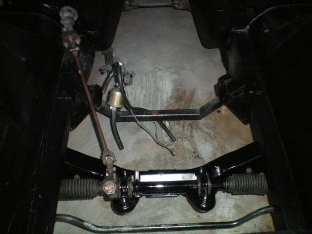

Here is a picture of the Vildini Mount, its a weld on mount but honestly i like this over other mounts becuase it ties the frame rails together and makes it feel alot more stiff. The mount allows you to use your stock motor mounts too.

I actually bought the Vildini Motorsports weld in engine cradle, the trans mount i fabricated myself, driveshaft was cut, welded and balanced by a driveshaft shop. Actually most of my parts will be up for sale soon since im going LS power on my Z

When i did my Sr20det swap on my Z, ( sr20det and kA24de bolt up exactly the same) I had to make a trans mount that bolted up to the trans tunnel, since the 280z trans mount location is different with the KA/SR trans, also you will need a custom driveshaft, since it actually needs to be shortened and fitted to the KA/SR splined shaft.
