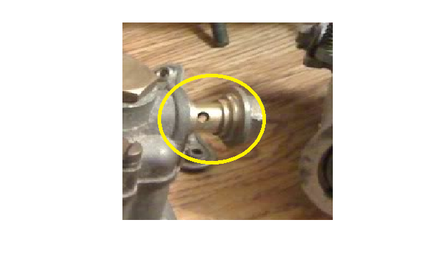

FubarI33t Posted March 1, 2010 Share Posted March 1, 2010 I am looking for the size of the highlighted part on Weber 40MM carbs. I am not near the carbs, and trying to order some parts before i get home. Quote Link to comment Share on other sites More sharing options...
2fast2Z Posted March 1, 2010 Share Posted March 1, 2010 Try to Google "weber banjo fitting" Quote Link to comment Share on other sites More sharing options...
FubarI33t Posted March 1, 2010 Author Share Posted March 1, 2010 Ok from google i got 12mm x 1.5 thread. Rekon if this is right. i am going to order three new ones. Quote Link to comment Share on other sites More sharing options...
brokebolt Posted March 2, 2010 Share Posted March 2, 2010 Yes, Fubarl33t that is correct. Weber DCO = 12 mm X 1.5 mm threads Dellorto DHLA & Mikuni PHH = 12 mm X 1.25 mm threads Solex ADDHE = 9 mm X 1 mm threads Any O.E. R. or SK Racing users care to post? Quote Link to comment Share on other sites More sharing options...
