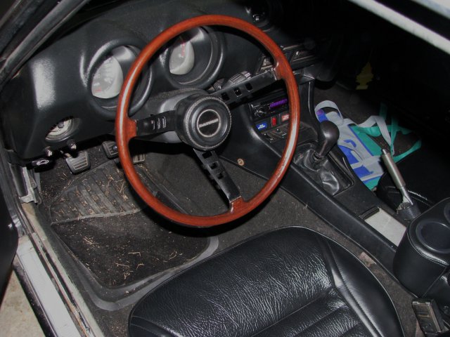

leftover z Posted March 20, 2010 Author Share Posted March 20, 2010 I went ahead and did this on my own. Basically, I taped off what I didn't want painted. Sanded the metal spokes and hub with fine sandpaper. Primed. Painted with Krylon Satin Black. Waited a couple days, then taped off all the metal. Lightly sanded and used fine steel wool on the "wood". Stained it with Cherry stain/polyurethane combo. Light steel wool between coats. Finish off with a couple spray coats of Clear Polyurathene. Came out pretty good for an amateur. Quote Link to comment Share on other sites More sharing options...
psdenno Posted March 20, 2010 Share Posted March 20, 2010 Looks good! How long did you wait between coats on the "wood"? Dennis Quote Link to comment Share on other sites More sharing options...
leftover z Posted March 20, 2010 Author Share Posted March 20, 2010 Looks good! How long did you wait between coats on the "wood"? Dennis Thanks Dennis. I think the recommendation on the can was 6 hours, but I waited 24 hours. I kept the wheel in the house to help cure it because my garage is not heated or insulated. It has been getting down to the low 30's here lately (cold for Oregon). Quote Link to comment Share on other sites More sharing options...
