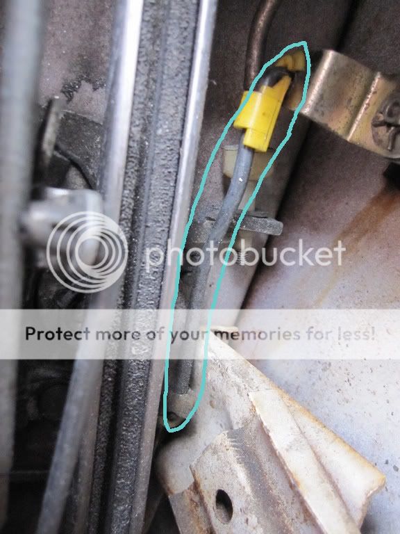

I tested the washer/shim method on the passenger lock cylinder and put it back in. It worked. I then did the driver side, and it didn't work. I figured I'd follow the advice in the instructions above and swap sides. Driver side still didn't work.
I got in there and analyzed what was going on. I used a spare door latch mechanism to understand it. The lever that the lock cylinder rod pushes down on is a little loose on its mounting point. It rocks slightly, keeping it from engaging the lock. The other end of the lever may be missing some bushing or something.. it seems to have a ton of play. I realized getting the latch mech out of the door requires removing the window track... I don't want to get into that right now.
I decided to keep it simple and extend the lock cylinder rod by just straightening it out. I removed it and put it in my vice. Got it perfectly straight and reinstalled it. The lock works like a charm now!
That's the rod. You can see the curve in it. It works fine if straightened, and gives that extra movement my mechanism needed to engage the lock.
