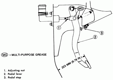

I'm hoping that it is a clutch pedal height issue, but I have not ruled out a bad master or slave cylinder. When I tried to adjust the pedal height last weekend, I could not turn the nut on the master cylinder push rod (under the dash). It looked like there was plenty of multi-purpose grease on there and didnt look rusted together, but it did not want to move. Am I supposed to clamp down on the rod with some pliers first, and then adjust the nut to give more travel? (Should the nut go towards the front of the car, or towards the back???). When I checked the fluid level in the master cylinder reservoir, it was low. Topped it off and need to check it again to see if I have a leak.

What am I not thinking of? The above diagram shows the adjusting nut...for some reason I thought there was supposed to be a lock nut as well? Open to any and all suggestions.

No - the nut IS the locknut. Loosen it, and then spin the actual shaft of the master cyl. for you adjustment. May need a pair of small pliers to do so.

Thanks 280Zme, I think I confused the master cylinder rod adjustment at the pedal, with the slave cylinder adjustment on the tranny. I know on the slave,for 70-72 it can be adjusted and there is a locknut. I just havent had a chance to get under the car with a helper to push the clutch in/out to see how much movement I'm getting at the slave cylinder rod. I'm thinking this may be the culprit, if not air in the system.
