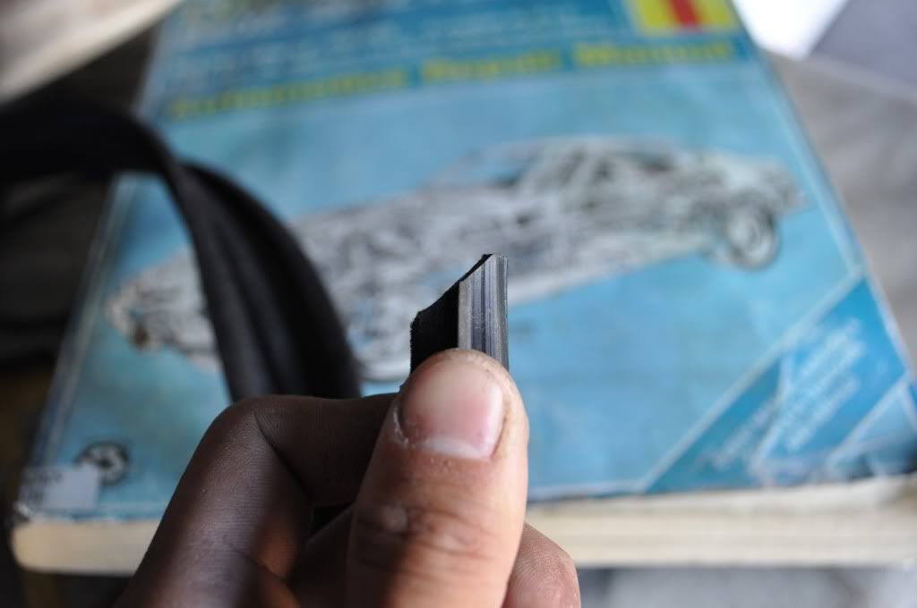

MUAH-HA-HA-HA THE FELT CHANNEL STRIP WORKS!!!! ... now that i got that out. the overall process to get to the installation is kind of tedious.

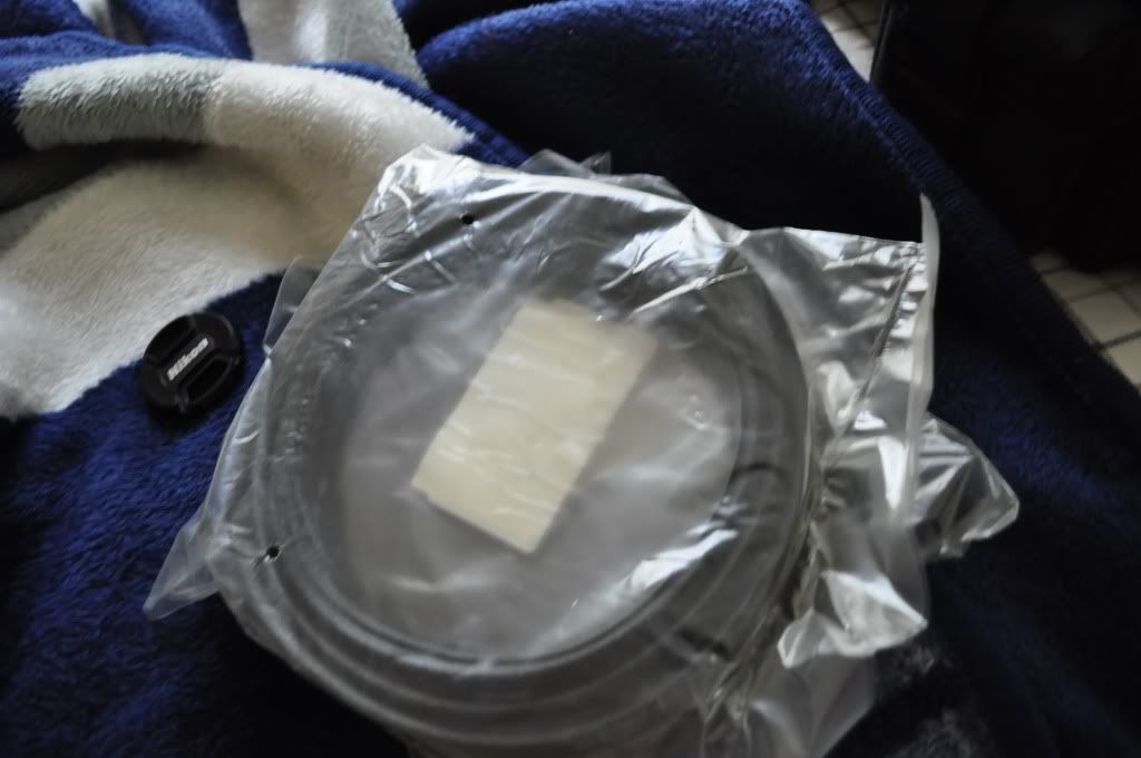

i got the strips today when i woke up and they seemed like they would work perfectly.

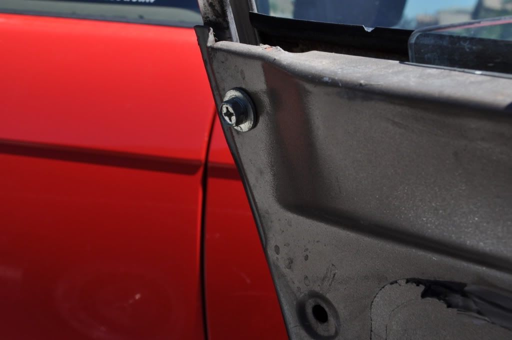

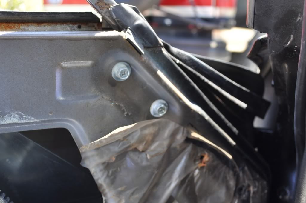

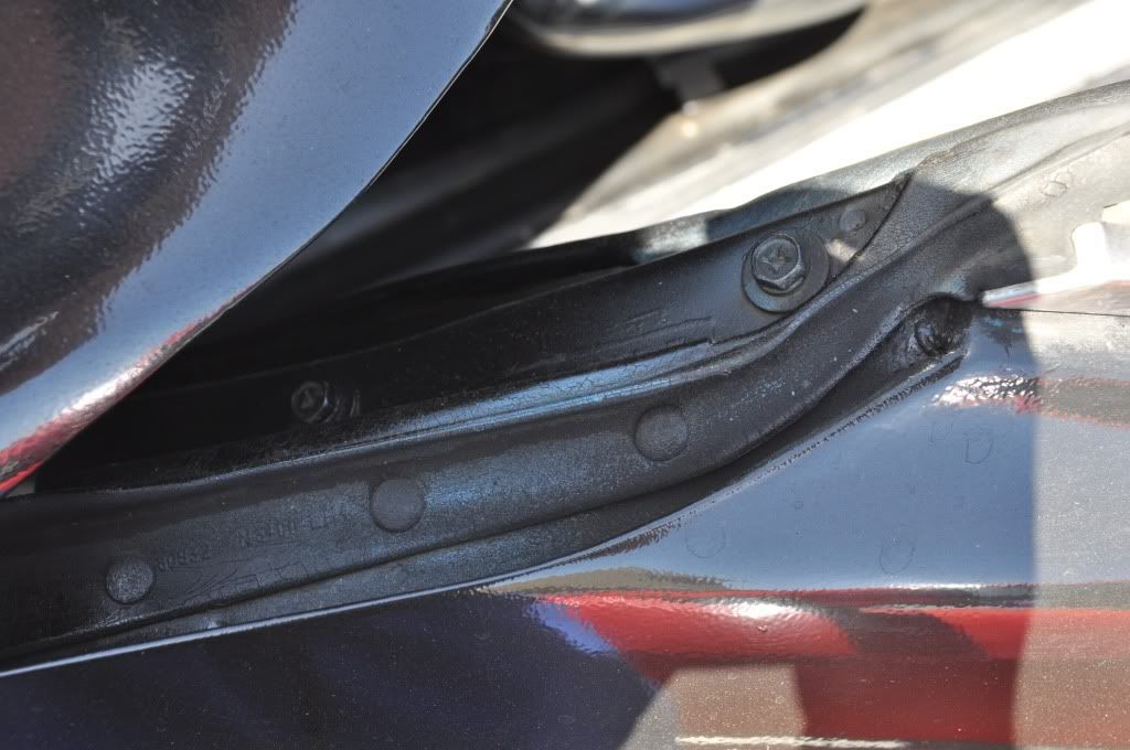

you have to unbolt 5 visible door bolts, take off you door panel and remove 3 more bolts,

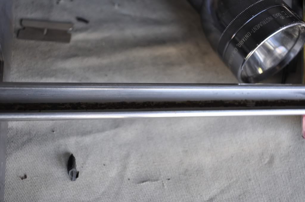

then pull and wiggle the chrome channel out without breaking anything inside the door.

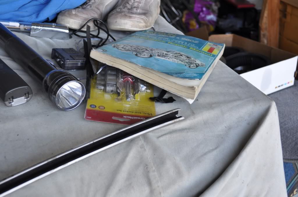

when you get it out, you have to take a flathead screwdriver to remove all of the old felt strip.
do not test fit, when the strip is in it is difficult to remove without damaging the material
use acetone or any cleaner to clean the channel itself and prep it for adhesive and the new material.

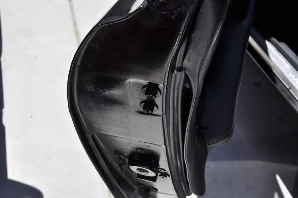

MAKE SURE TO CUT 45 DEGREE ANGLES FOR THE RIGHT ANGLE IN THE CHANNEL THIS IS WHERE YOU WILL START INSTALLING!!!!
put a solid bead of adhesive in the channel and press the strip in firmly.
cut before reaching the bolt threaded holes
one 6 foot strip fits the door WITHOUT EXCESS. i was surprised... it took me all the way to the end
i need to find the rubber strip the goes on the door trim
the inside fuzzy stripping is in really bad shape
