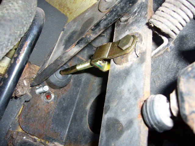

MikeBZ Posted June 5, 2010 Share Posted June 5, 2010 Had lots of slop in my clutch pedal, I thought maybe the return spring had broke but it was the clevis pin that connects the pedal arm to the clutch master cylinder...... How many more shifts do you think I had..... Check yours! And the brake pin. Quote Link to comment Share on other sites More sharing options...
GrenadeZ Posted June 7, 2010 Share Posted June 7, 2010 where is this pin located? I think im having a similar issue Quote Link to comment Share on other sites More sharing options...
MikeBZ Posted June 7, 2010 Author Share Posted June 7, 2010 where is this pin located? I think im having a similar issue Its under the dash, at the top of the clutch pedal where it pivots and pushes on the clutch master cylinder. Its the pin that attaches the master cylinder clevis to the pedal. Here's a pic, its not my car, but you get the idea Quote Link to comment Share on other sites More sharing options...
GrenadeZ Posted June 7, 2010 Share Posted June 7, 2010 I am almost positive the push-rod is moving but I have no pressure. Ill check this out, might just be time for a new master. Thanks! Marcus Its under the dash, at the top of the clutch pedal where it pivots and pushes on the clutch master cylinder. Its the pin that attaches the master cylinder clevis to the pedal. Here's a pic, its not my car, but you get the idea Quote Link to comment Share on other sites More sharing options...
