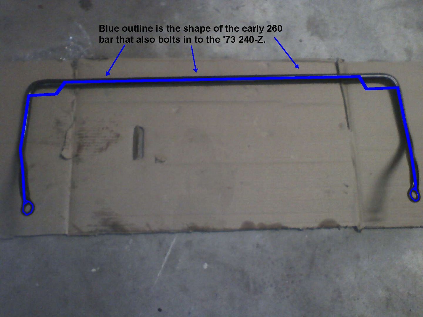

That bar is referred to as the 280 bar. It will only fit the "late" 260 and all '75-'78 280 cars. Body mount for that bar is cantilevered forward of the frame rail structure.
The early 260 bar has a dogleg in it where it attaches to the body, (see pic). The early 260 and even the '73 240-Z have rear sway bar mounts directly under the frame structure vs cantilevered forward of it as on the late 260 and '75-'78 280-Z. The '73 240 came with the mounts on the car, just no bar so the early 260 bar is direct bolt on for the '73 240, (I seem to recall that some if not all the '72's also have that mount? I could be wrong...)
In short, that bar will fit late 260 and all 280 cars.

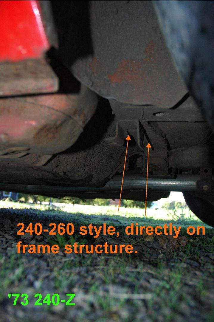

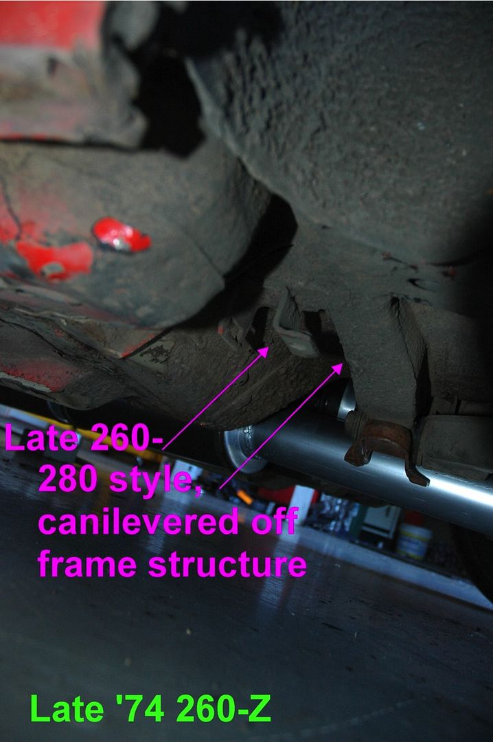

Here are pics of both style mounts.
I am not sure what the cut off is for the early vs late rear mount on the 260. The 260 was the year Nissan used to empty their parts bins of the 240 body components and they did, (either 5 or 7 different plants these cars were being produced in), they would then use the 280 bits. Have seen 260's with the tiny front bumper and large 280 style rear bumper, etc. I would guess there is no cut and dry date, production number etc that would determine early vs late, just have to crawl under the car and see where the rear sway bar mount is attached, on the frame structure or cantilevered forward of it.
EARLY rear bar mount, picture is of a '73 240-Z;
LATE rear bar mount, picture is of a late '74 260-Z;
Hope that helps,
Paul

Excellent! Thank you Paul! The bar I have was definitely from the earlier style mount. Your information is perfect!
Thanks again!
Tim
