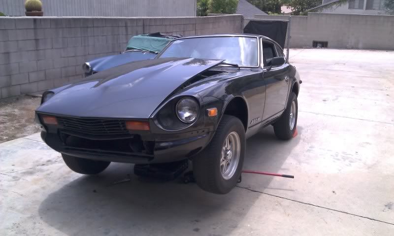

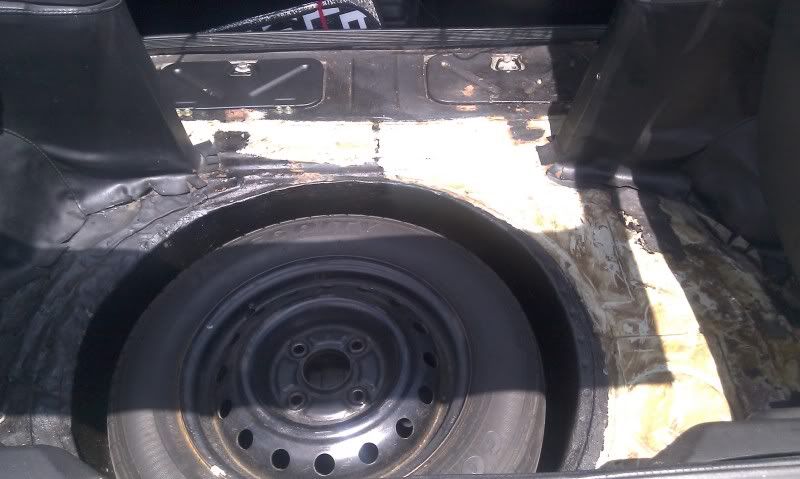

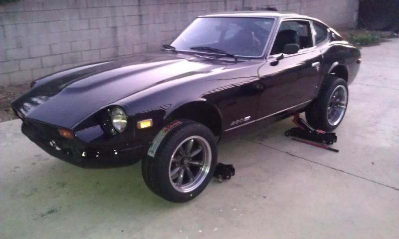

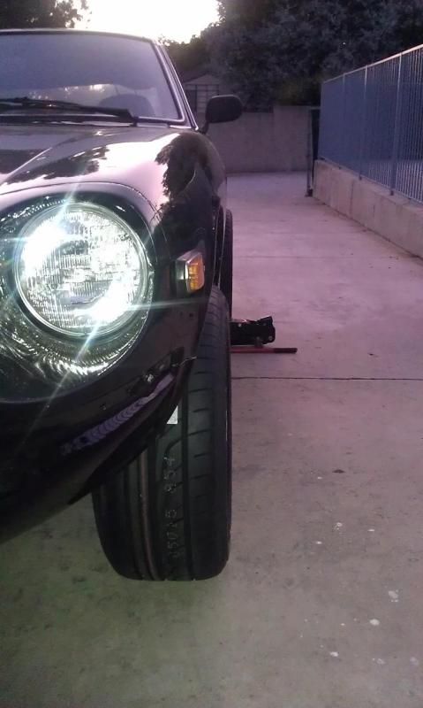

Indey Posted July 20, 2011 Author Share Posted July 20, 2011 Alright so my wheels came in, unfortunately the fronts were a full flat black, instead of a flat black with a polished lip. Oh well they were going to have to be redone anyways right? SO here's a few pictures of random stuff, and test fitting of the wheels. Random of the car... As stated previously I had taken out the rear sound deadening, and the floor board looks rather....wavey, is this normal? and if not can anything be done about it? Monster truck oil change... 16x8 +10 Flat Black 17x8.5 +4 Gunmetal with a polished lip Fitting on the car...with the R40's Herra Frush. Now the issues =P I'm definitely going to need spacers, I plan on running a 8MM spacer all around, effectively making it a F:+2 and R:-4 Offset Rear Clearance. Front clearance...or well...lack there of clearance. And from far away to give it an overall look. Now the question I pose to you guys, does ARP make a set of extended studs for our cars? or am I going to have to go out and measure the stock studs and give them the specs so they can give me what i need. Quote Link to comment Share on other sites More sharing options...

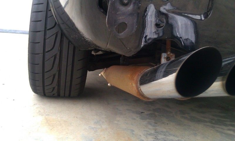

Indey Posted April 11, 2012 Author Share Posted April 11, 2012 Great progress. I was just curious about the msa twice pipes you have there. Can you take pics on how the exhaust was installed. I also have the rbr but the exhaust shops said they couldnt install the exhaust cause there is no more space. Thanks Huh.. That's odd mine fits with no issue, if you check the pictures above theres a back shot of the car somewhat showing the clearance on it. I'll try to get some better pictures when I'm at home however, what size RB-R's are you running? Quote Link to comment Share on other sites More sharing options...
draztik280 Posted April 11, 2012 Share Posted April 11, 2012 Im running 17x9.5 rear Quote Link to comment Share on other sites More sharing options...
Indey Posted April 12, 2012 Author Share Posted April 12, 2012 Im running 17x9.5 rear Could be why, I'm running 17x8.5 +4 w/ a 10mm spacer. Here's my clearance however. Quote Link to comment Share on other sites More sharing options...
