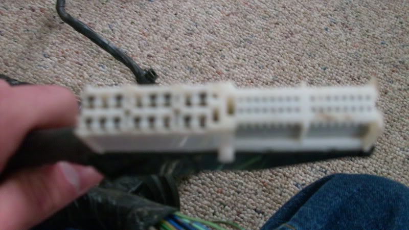

RB25DET Series 2 interior loom pin-outs?
Bernard Lim
? Whats the problem?
The series 2 wires are almost identical to the series 1 wires, they just have a different connector/s. Follow Chris Rummel's page up in the stickers and sort out the wires you need.
The only problems your going to run into is the ignition power circuit for the series one is deleted and one of the other wires is the wrong color, but can be traced to the ECU pinout for verification. I would suggest removal of all the extra wires that use to run windshield wipers, headlights, etc. that happen to share the harness to narrow down what you need. If you need a detailed wiring schematic I can host if you can make heads or tails. It helped me out, but its for a series 1.
