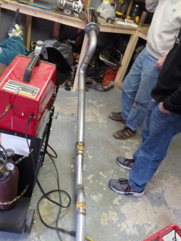

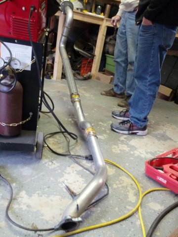

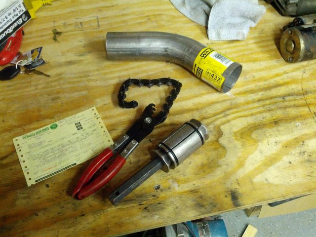

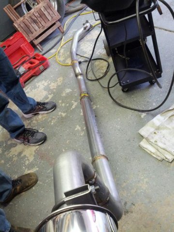

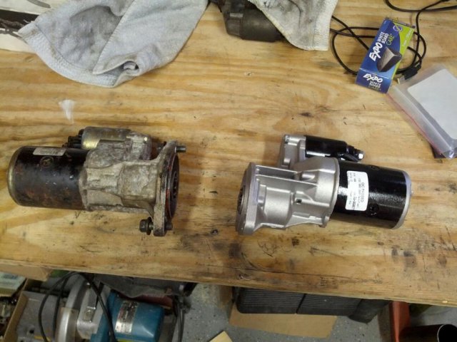

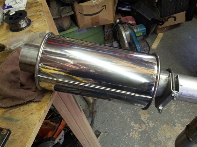

Got my exhaust system fabled up today! Used 2.5" to get to the tranny tunnel then bumped up to 3" all mandrel bends. The pipe expander did fine on the 2.5" pipes but almost striped the threads trying to expand the 3"ers. So I used a coupler on the last two elbows before the dynomax ultraflow. Video to come soon on the sound:). Super thankful to my awesome neighbor for the use of his expertise, welding skills, and general willingness to help! Pics below are of the new starter, old ones brushes were so worn the shoes ate away at the copper, the boost gauge location, for now, thought I might like it down by my right leg but its too far from a quick glance, and the GM module. Also put in new injector wires, still chasing a misfire....me and the neighbor made a smoke machine to check for a vacuum leak as I'm running out of ideas. Maybe ill show a vid of that as well. Till next time.

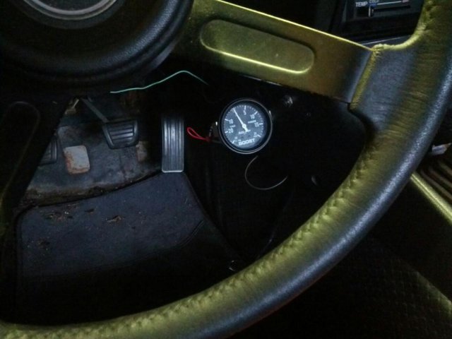

I definitely learned a lot. Was going to go for the z31 ECU and will most likely when I'm ready to turn the boost up. Just trying to get her reliable, still need to fab up my exhaust and mount my boost gauge somewhere. Hope the body work goes well. Much more straight forward then trouble shooting electrical issues

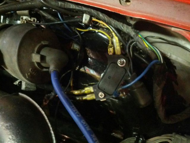

Been awhile since I updated. Cars been on timout due to the frustration its caused me all summer. Couldn't get any help on the electrical forum for my ignition problem. I somehow just lost spark all together and couldn't figure out why. I noticed the green light on the ECU was staying lit while cranking and that didn't seem right. No one in the electrical forums responded when I asked the question why that might be so I figured no one had experience with it. I tested just about every pin and found that the ignition signal pin wasn't reading while cranking. Put in a new GM module and Coil but no luck. Went to the junk yard and got a CAS out of a 92 Maxima, no luck, but green light turns off when cranking. figured something was up and wasn't ready to condem the computer. I did have the key in the on position for a long time right after I installed the new module and thought maybe I fried the coil and/or module. New coil; no luck. New module. BAM spark! Still has a major cold start problem, under the impression its fuel related as my fuel is still bleeding back rather quickly IMO, maybe some air getting in the line. Basically the entire ignition system is new minus the computer. Drove around the block today for a good 20 minutes while the engine was nice and hot and it kept on running! Not a perfect idle but it didn't stutter and die! So a win for now Hopefully this problem is behind me and I can move forward with my build! More to come.
A little background. I recently finished a turbo swap L28 ET into a 260z. Car ran and drove but hasn't been quite right....mostly idling issues. Then cutting out issues now no start, no spark issue. The car basically got harder and harder to start each time but would always start eventually. So just yesterday I went to start it up and nothing. Checked for spark and no spark at the coil. Also noticed the tach didn't move at all (cant remember if it used to) and the green light on the ecu stayed on during cranking(used to shut off during cranking and stay off once started). Got out the FSM and starting checking readings at the ecu pins. Pin 9 (ignition signal), supposed to read battery voltage, had nothing while cranking. Pin 8 (CAS) read 4.95V but couldn't see it pulse because of my cheap multimeter. Pin 17 (CAS) read .2V and would drop to zero when cranking? My first thought was to ignore the low reading on pin 17 since I can't find any info whatsoever on testing the CAS on this car. ....annoying the crap out of me. And to try a new ignition module. Bought an HEI module from autozone and wired it up. No luck exact same problem. My questions are 1. Why would the light stay on on the ECU while cranking? 2. How do I test the CAS? I'm leaning towards the ecu being bad and am just about ready to find a z31 ecu and MAF and quit on the stock system.

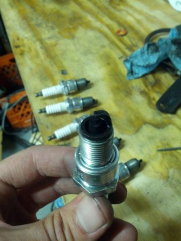

OK, here is a video of it running.... I also went ahead and pulled the plugs just to check em again since I hadn't in a few days and all fouled? might be coincidental since I was messing around with the MAF a lot this afternoon ...but not so sure hmmm.

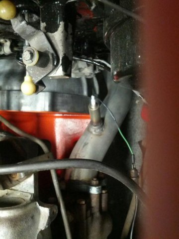

Thanks, I've been driving around, but I'm still not out of the dark. Still idles bad after it warms up, like its flooding. Consequently, I had to pull the O2 sensor out of the old down pipe when I went to install the motorsports down pipe to do my exhaust system. Tested it while it was out and it was bad so I got a new one, thought it might help my running rich issue but no dice. I'm thinking ill check out if my CHTS is working since it runs great until its warmed up. Also, still think I have a leaky injector or 2 since it's still hard to start. like it's flooding.
