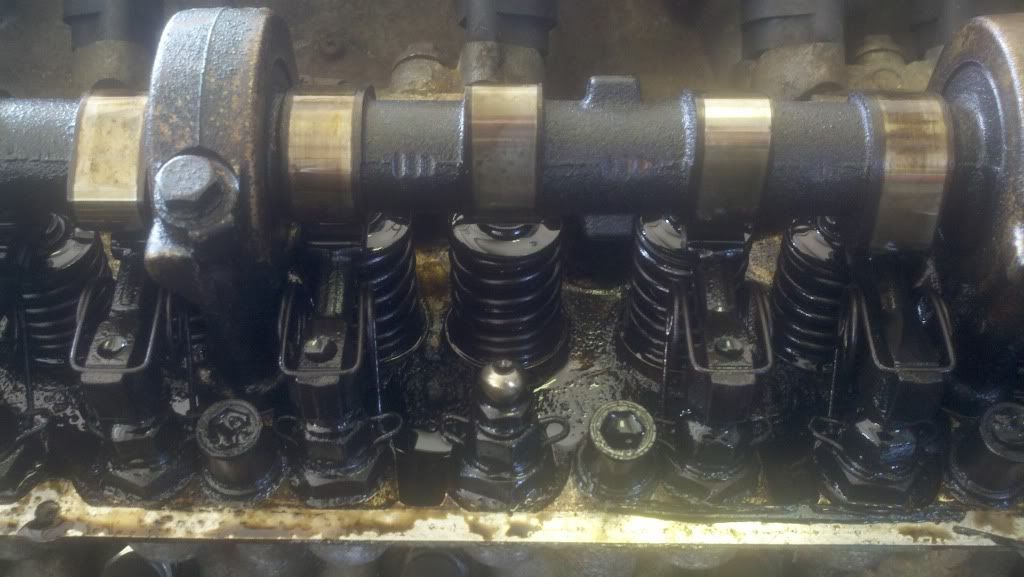

well i believe i might have found the problem atleast i thought so i put the missing rocker arm back on and it runs good it has a low power but it runs the best it ever has now there is another problem well 2 actually there is a huge air sound coming from the front of the car when i rev and it it bogs out and the fuel pump is running all the time and it sounds like its straining when i rev it in park it sputters and back fires until gets to about 2500 rpms and it runs good

Missing a rocker arm IS a problem and you need to figure out WHY it came off.
"Huge air sound" like a stuck fan clutch?
It's normal for the fuel pump to run constantly.
Have you cleaned all of the corrosion out of your FI connections?
