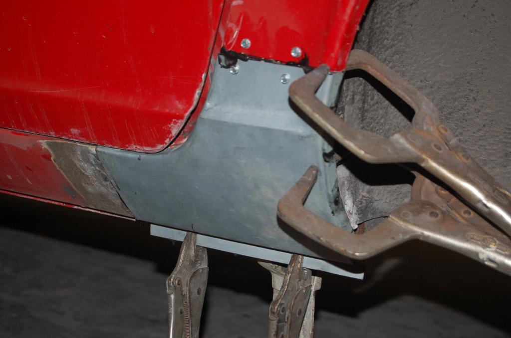

I made a backing plate out of the left over material I cut from the patch panel. I screwed the backing plate to the inside of the ¼ and then screwed the patch panel to it. I then disassembled the piece and got the adhesive gun ready. I reassembled everything but this time with adhesive on all of the contact areas.
I made sure that I had a large enough bead so that it would create a water tight seal as well.
