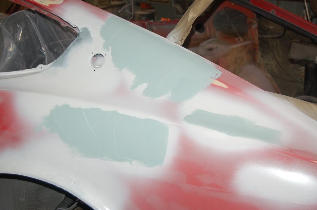

I put a coat of duraglass down first. Then I top coat with bondo. Duraglass is much stronger than the bondo and is waterproof as well. The bondo I chose is Rage extreme. It was expensive but it laid out easily and sanded like butter. Only do a few areas at a time so you can work the bondo during its optimal sanding period.
Also do a search on guide coating and use it!!
