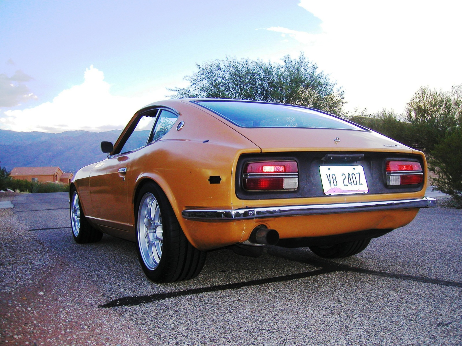

Currently (as of 09/15/2014) installing a 376/480 GM LS3 crate motor and TKO600 transmission using an Autoworks Racing shifter relocation kit. Techno Toy Tuning rear suspension setup using an R230 rear end, shortened axles and 5 lug hubs from a 1991 Z32 Twin Turbo. Aluminum 5 lug front hubs. 4 wheel Wilwood discs and calipers. Sectioned struts with Tokico Illuminas. Enkei PF01 wheels, 17 X 8 front, 17 X 9 rear with Michelin Pilot Sport PS2 tires, 245/40 front, 265/40 rear. Custom built fully adjustable lower control arms, front and rear. Seibon carbon fiber hood. Xenon front air dam.

Looks good Mike! I am not a fan of the fender flairs and I was under the assumption that I couldn't fit a 17x9 without em, after seeing your rears I am inspired to go with the wheels that i want that only come in a 9". Thanks for posting.
