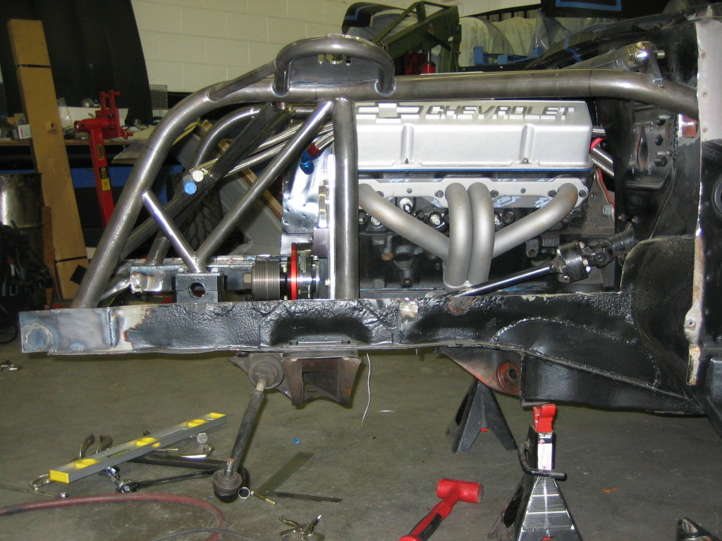

Well when I took this pic it was 10:45 Sat Night. It took 8.5 hours to make all of the tubes and fit them up. I've moved the sway bar on top of the frame and reinforced it. The vertical tube also holds the motor plate and ties into the main front down bar. My machinist/ cousin made these trick sloted plates out of 3/16 chromoly plate. Very nice!!!
