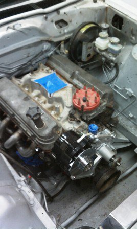

Thanks superior78-z for the compliment. Sorry for not responding right away. I have been in the process of moving the last couple of weeks while also trying to get this z on the road at the same time. I have the car running and took it for a test drive but am having problems with the transmission. When i put it in gear it takes off fine and goes about 5 feet and then wont go any further. It is almost like something is locking up. I am in the process of pulling out the tranny now and will have someone look over it for me. I will load more pics soon and fill in with details on what parts i had to use to make everything work. If anyone could think of what might be my tranny issues please let me know what you think. thanks.
I will be running the T5, but havent gotten to that point yet. I will be using all aftermarket guages though.

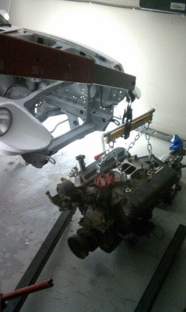

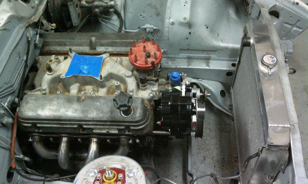

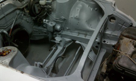

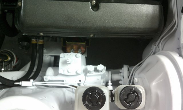

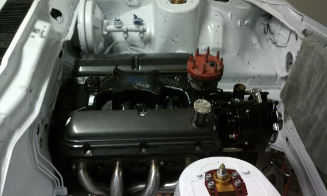

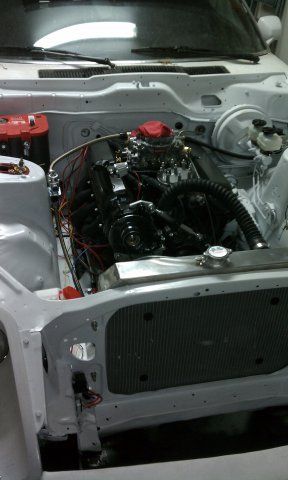

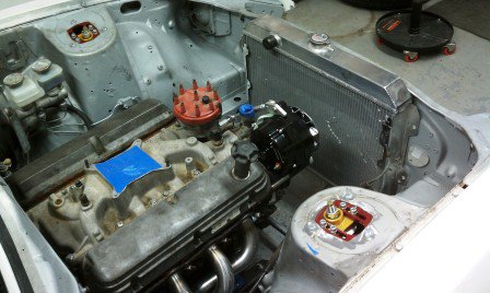

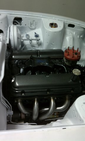

Hey Bmies! This was my first swap to and it has been fun and frustrating. First off JTR already makes motor and tranny mounts for a sbc. This would have been so much easier, but i really wanted to put a 5.O into it. The engine is an 87 i believe. It had already been converted to carb. Eventually i will probably go fuel injected. I am using a T5 transmission which fits pretty good when the motor is as close to the fire wall as possible. I was actually able to use the factory transmission mount in the tunnel. It might have to be reinforced though. As for motor mounts i bought urathane mounts for the motor and then made some plates that are bolted for now to the crossmember, but will be welded in completly soon. ( I can post some pics soon) The headers are Summits tight tuck headers. Will work great for passenger side. The drivers side is a different story. It will have to be cut and reworked. The rack style power or manual steering will not work. The steering shaft would have to go right through the mount. The power assisted recirculating ball steering will work great with a custom header. The rearend is a R180 right now. I have an R200 that I will LSD from my 83 or buy a R200 lsd from a 300zx. The suspention is from Techno Toy Tuning and Modern Motorsports. I had to section out the strut tower and bought shorter adjustable struts. Then welded on a perch for the coilovers to sit on. If you have any other questions let me know. Hopefully i will have it driving in a couple of weeks.

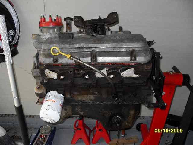

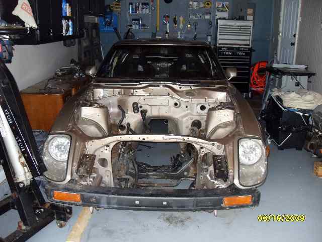

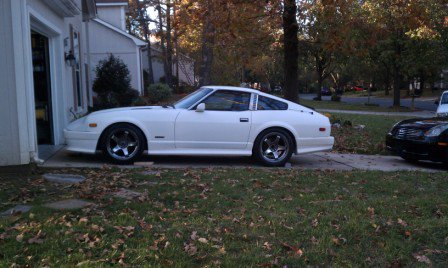

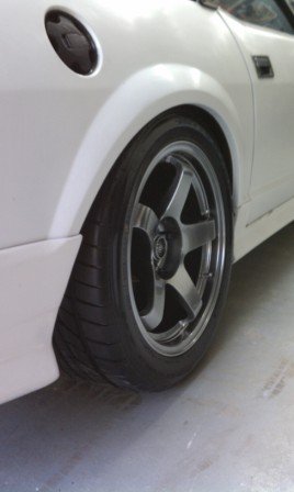

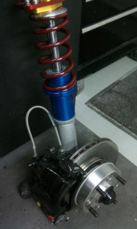

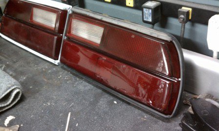

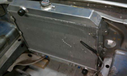

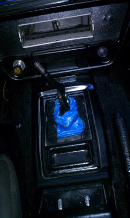

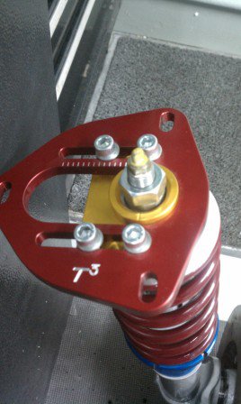

Hey everyone I just wanted to post some pictures of my build i have been doing over the past year. This is my second Z car and I still have the other one which ive had since i was 16. Over the last 10 years I have been buying parts and doing as much research as possible. After all said and done I decided to do the 5.0 build because I love the look of the Z, but the sound of a good mustang. Anyways here are some pics of the build. Any comments are welcome. Thanks.

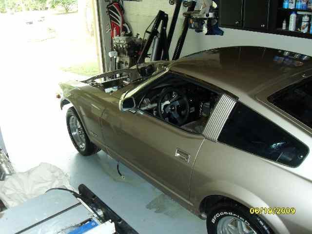

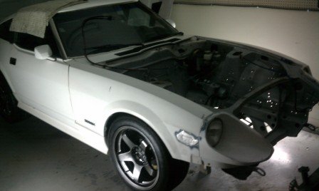

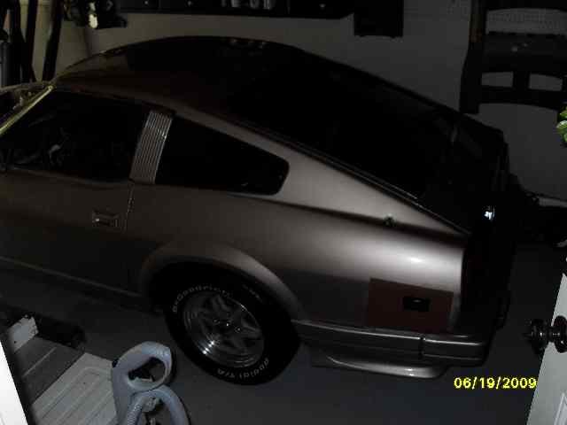

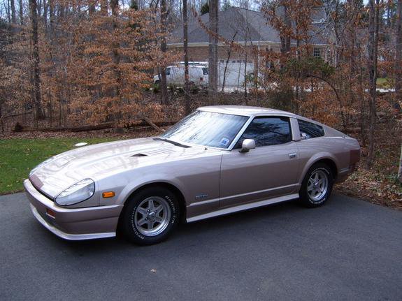

Here is a pic of my car back in 2002 and also some pics of it now. I am in the process of completely rebuilding the car with a small block ford 302.

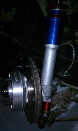

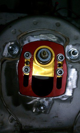

thanks guys. i called in an order for the front coilovers. by the way i have an 83 280zx and wondered if any one has the rear coil over set up. it looks really nice. i just wanted to see what people who got them thought about them. -
hey everyone i was just wondering if there is anyone who has bought the front or rear coil over setup from modern motorsports. I searched and have only see people talk about them but have not seen any pictures or heard of anyone purchasing there front or rear set up. If anyone has how long did it take to get and how low does the rear coilover set up go? thanks for any info
