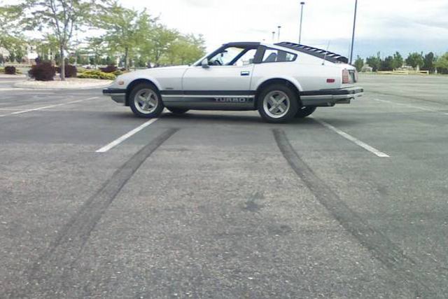

From the album: Idaho Z cars
Before it got blasted..... -
