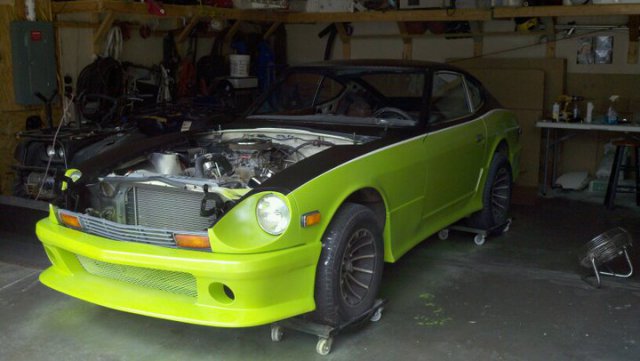

The green paint is "paint shop" line from duplicolor. The flat black is rustoleum mixed with acetone to thin it down. We read about it in I think car craft magazine and looked easy to do with good results and it worked really good. The white stripe is just some rattle can. It was real economical for us and not so intimidating for us to do another car in the future. Painting was easy, all the work that leads up to it, wow! Wish I was doing this when I was 17.
