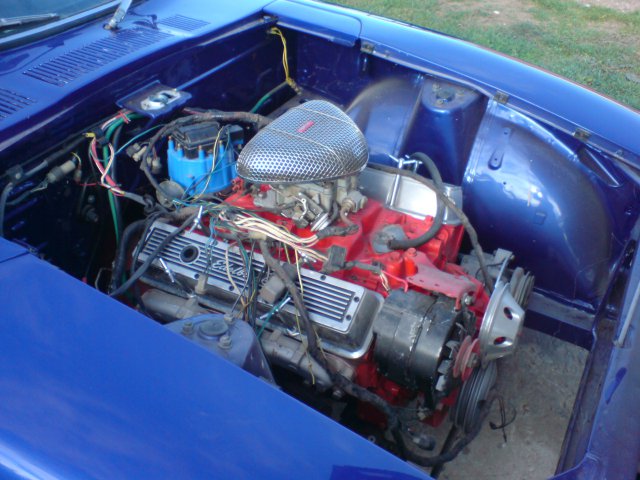

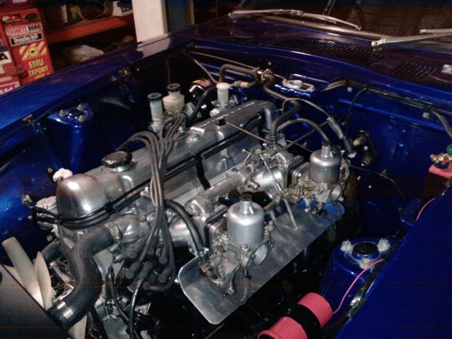

  2. This engine swap is to peg one back for Nissan. Before: 400 SB Chev After: L24
